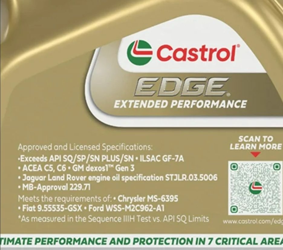

Atlantic British also carries the OE Castrol Spec:
https://www.roverparts.com/engine/mo...ives/CS15AF6F/
There’s the possibility the Mobil 1 actually meets the spec but doesn’t put it on the label due more to contractual reasons with Castrol. Back in 2022 and 2023 our dealer used Pennzoil 0w20 as the Castrol was unavailable. I asked the same question and that’s what they said. They switched back to castrol in 2024. My view is you’re safe since you got it from the dealer, FWIW.

https://www.walmart.com/ip/EDGE-Exte...ts/13408061157
Castrol 0w-20 Edge EP meets STJLR03.5006 spec and is only $26 a 5qt jug at walmart out of all places.
