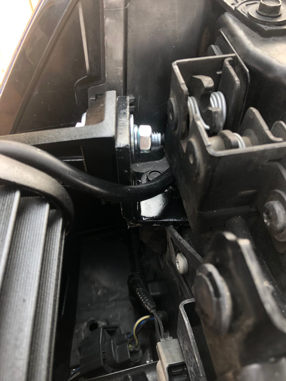

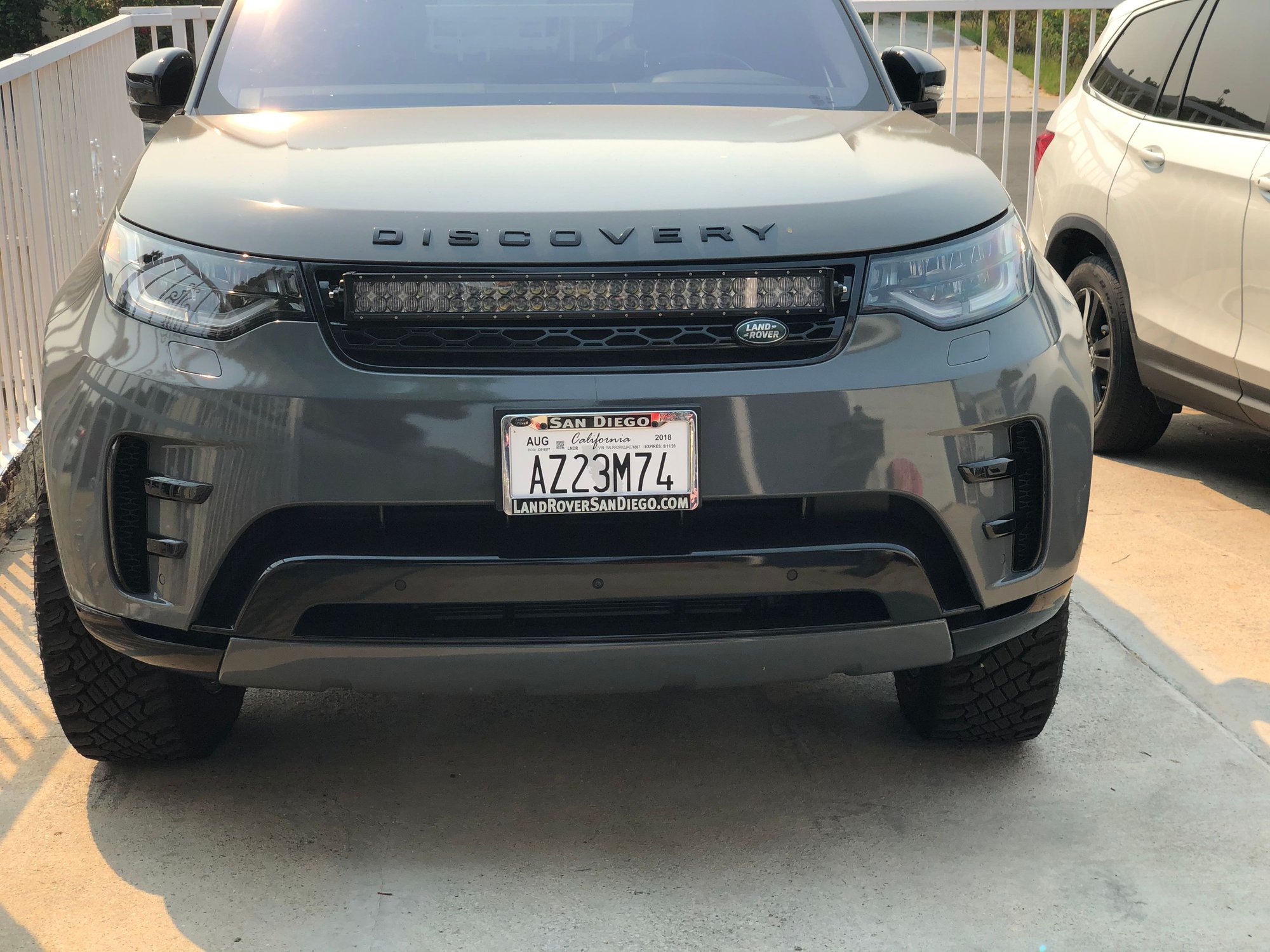

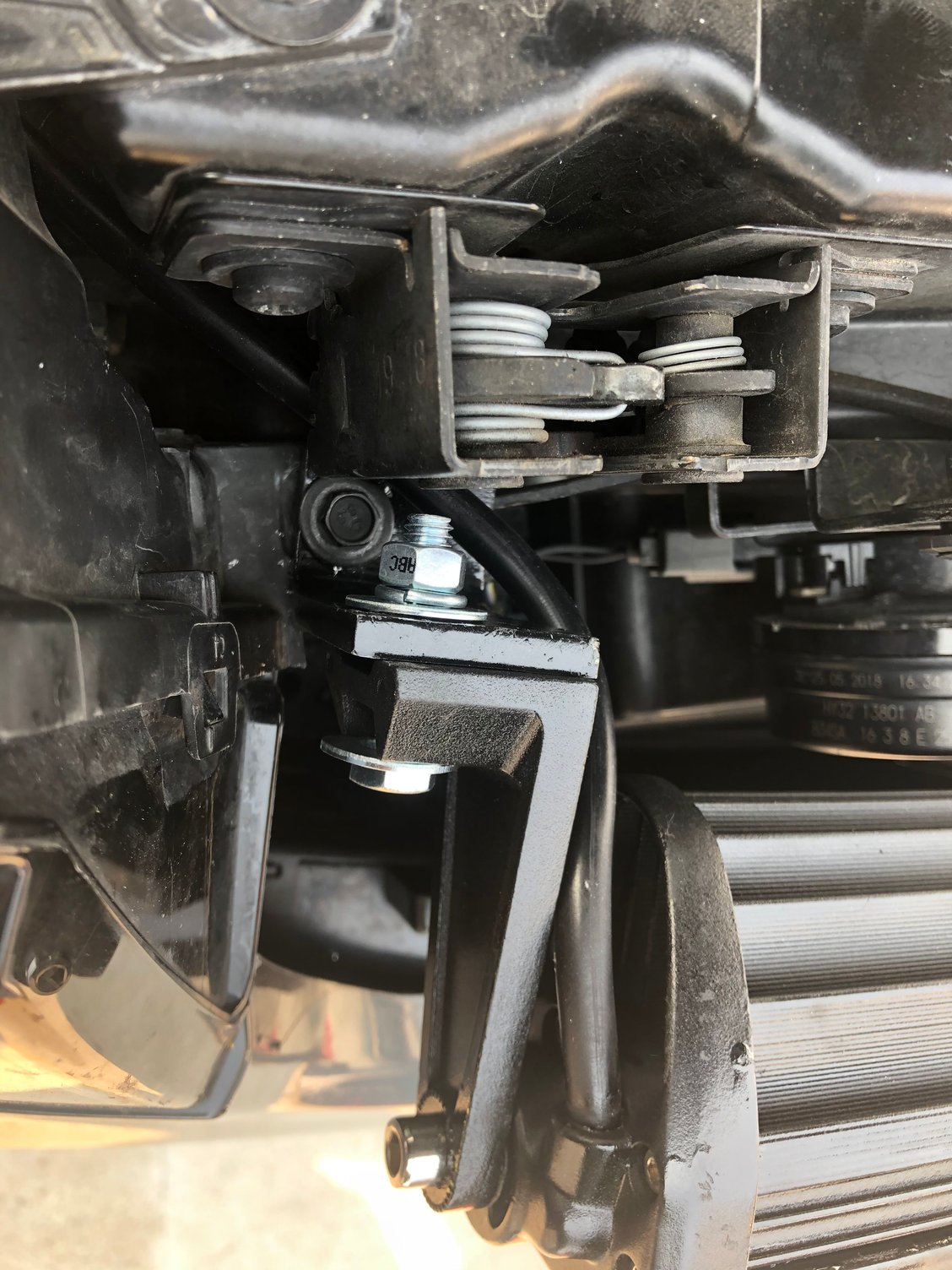

i went a different direction and went with a 32 inch curved bar made by Auxbeam.
cost me $100 for the bar and another $30 in bracket and hardware.

Looks great, was it a specific bracket?
nothing specific, just need a 90 degree bracket that measures about 1 inch wide and about 2 inches on X and Y.
you will attach this to one of the headlight bolts.

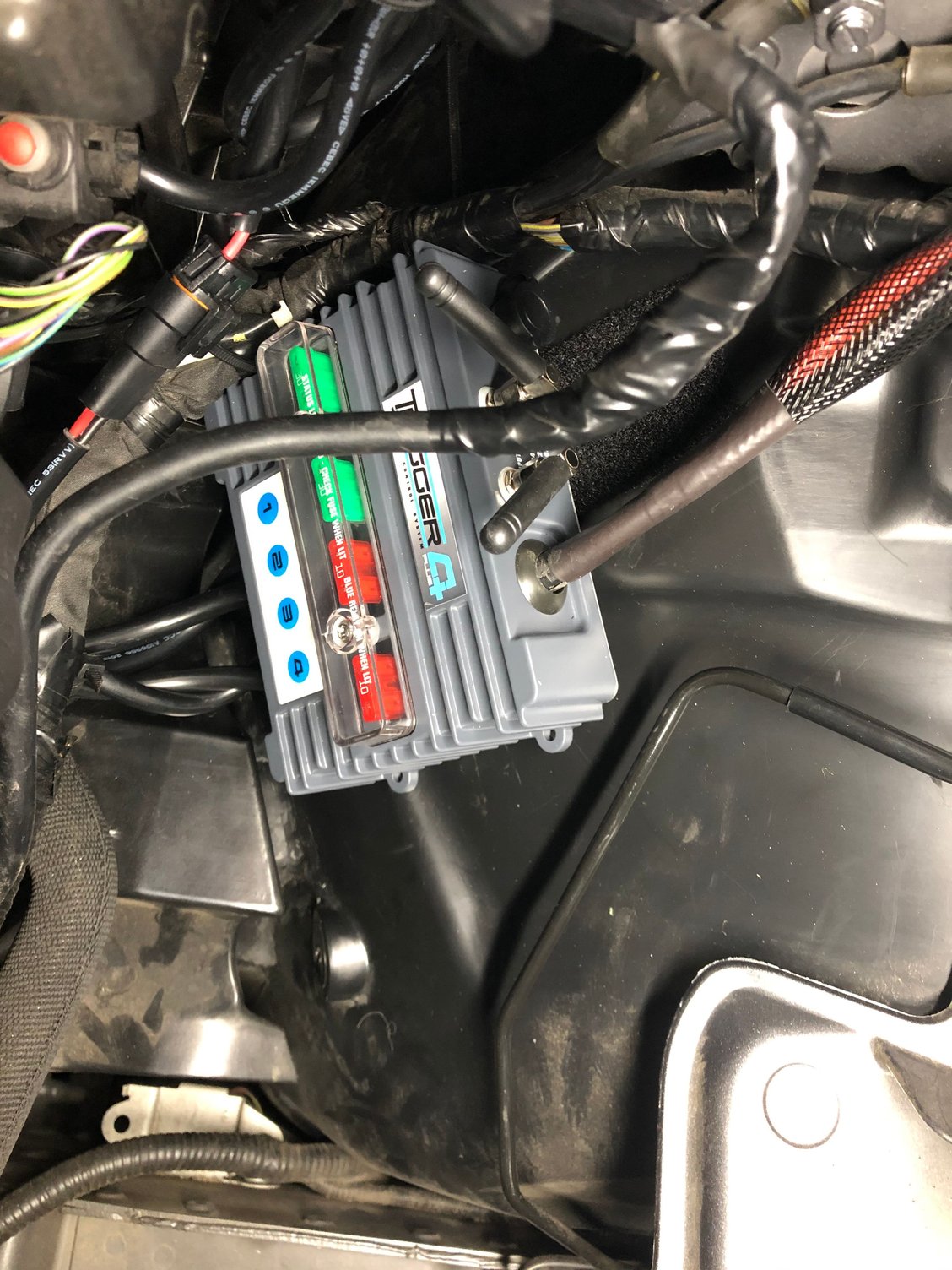

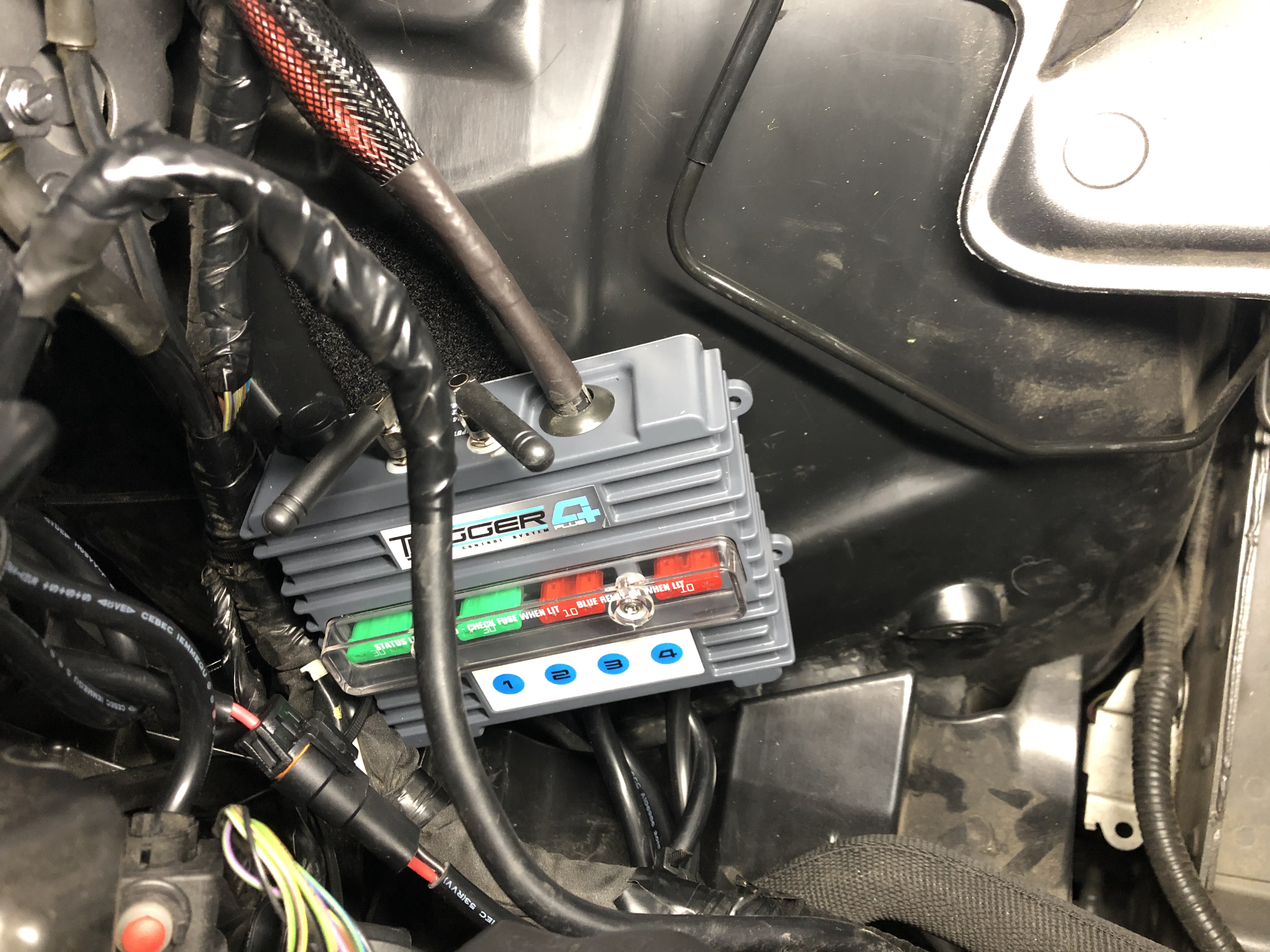

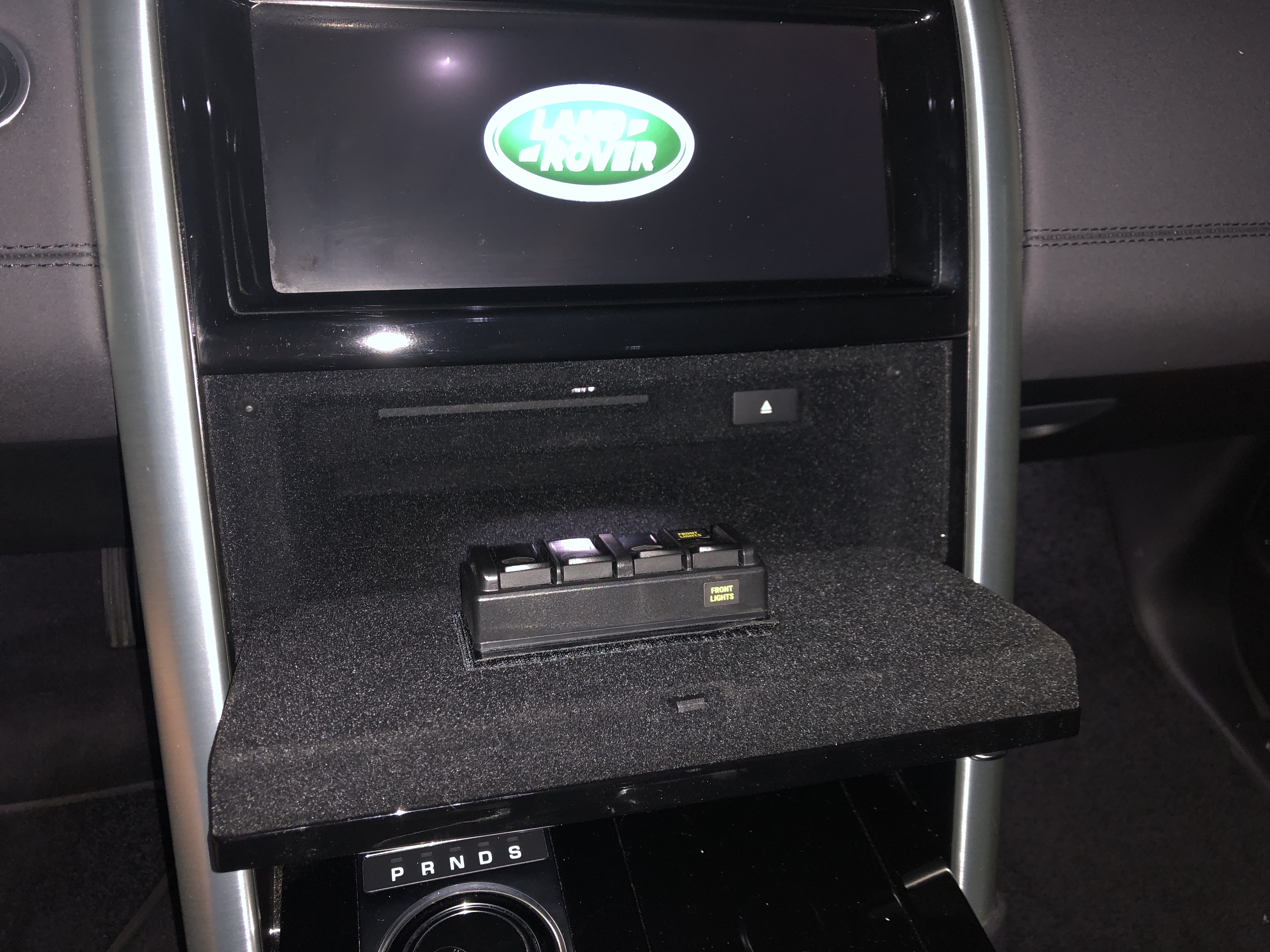

Finished with the wiring using the Trigger module, highly recommended.
no wires to run thru the firewall, you can control your lights with your phone and the freedom to put the switches where ever you want.
