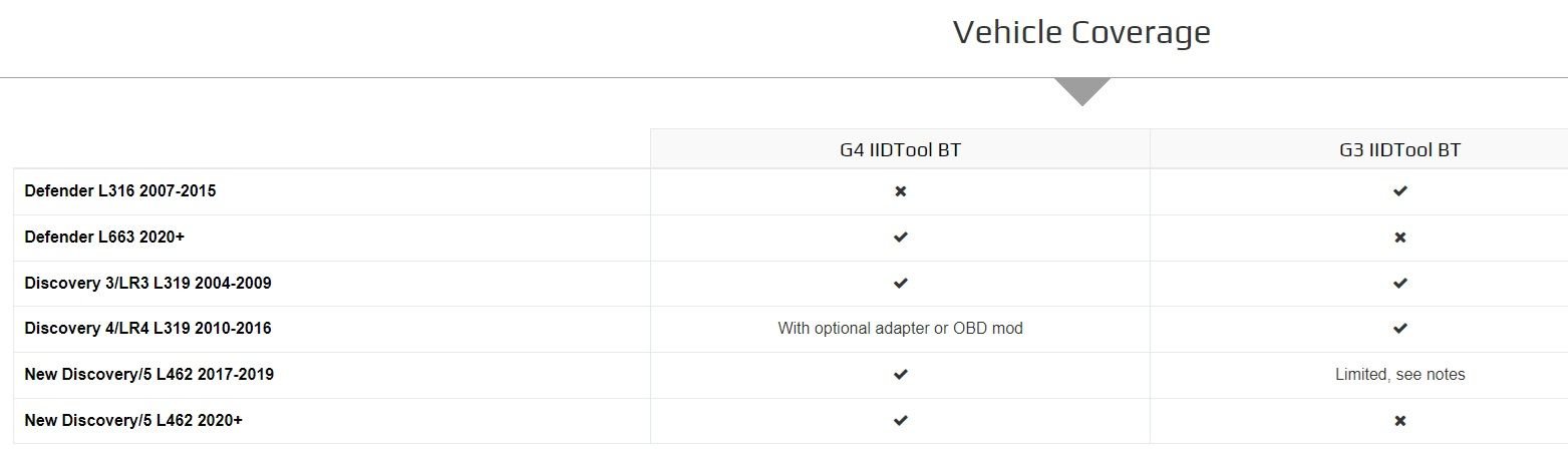

Just an FYI for everyone with the Gap tool version 3. They are offering a trade in program to go to the V4 that supports the post 2017 LRs better than the V3. You get the discounted price if the V3 was purchased after Oct 2022 . $123 for the update if you can send your V3 in first and wait. I also picked up the adapter cable for the earlier LRs (I also have a 2011 LR4) that will address some changes in the ODB2 port pins found on the new models. There is a really good chance that I will be changing over to a D130 here in the next few months, so I went ahead and took the upgrade.
IIDTool BT G3 to G4 exchange (Oct 2022-March 2024) - Gap Diagnostic (gap-diagnostic.com)
