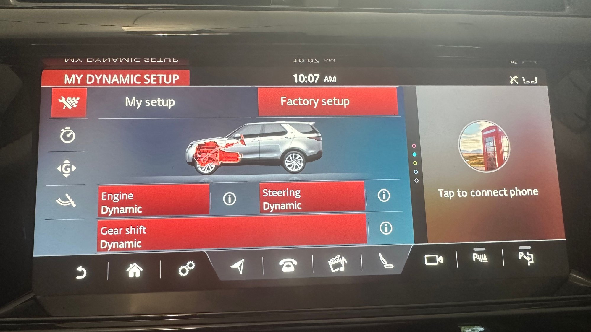

The Dynamic Mode settings below. After you change the settings, go to service, infotainment module, relearn CCF to activate dynamic mode screen.
If you have locking rear diff, you can activate rear torque vectoring to complete this package.
EUCD-129 Terrain Response Fitment, Set to "Auto Terrain Response Dynamic & Configurable Dynamic Mode"
EUCD-245 Dynamic-I
Standard: Dynamic-i Not Fitted
Changed to: Dynamic-i Content with Configurable Dynamic Mode Screen
MultiCAN-562 DynamicProgMode
Standard: Not available for selection
Changed to: Available for selection without timeout
MultiCAN-605 ConfigDynamicMode
Standard: Not Fitted
Changed to: Fitted
MultiCAN-777 Ter Dyn Select In FCPB
Standard: Control interface not available in FCPB
Changed to: Rotary used for selection within touch screen

Interesting. So with those settings I get all of the dynamic mode menus, but I can't see any way to enable dynamic mode. I've had a replacement terrain control **** with the dynamic selection on the rotary and installed that just now, but it still won't select.

You’re the second person with this issue, I’m hoping to get my Discovery back today, I’ll post a screenshot of my CCF.
You don’t need to change the terrain response ****, what we have works, you just won’t have the little dynamic symbol.

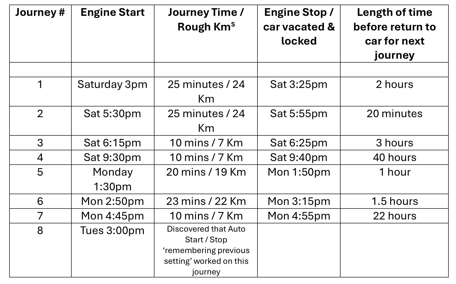

Default Auto / Stop editing via GAP IID4
Vehicle :-
L462 - Discovery 2024
Vehicle scanned on 18-09-2024 19:34
Using IIDTool BT V4.0 B0098-83
Setting Auto Stop / Start to ‘remember previous setting’ by editing (CCF) Multi-CAN 566
It didn’t work initially but worked on Journey #8 after the editing. Here is the information about the car’s activities between completing the edit and the Auto Stop / Start to ‘remember previous setting’ working. Many May find this info helpful
