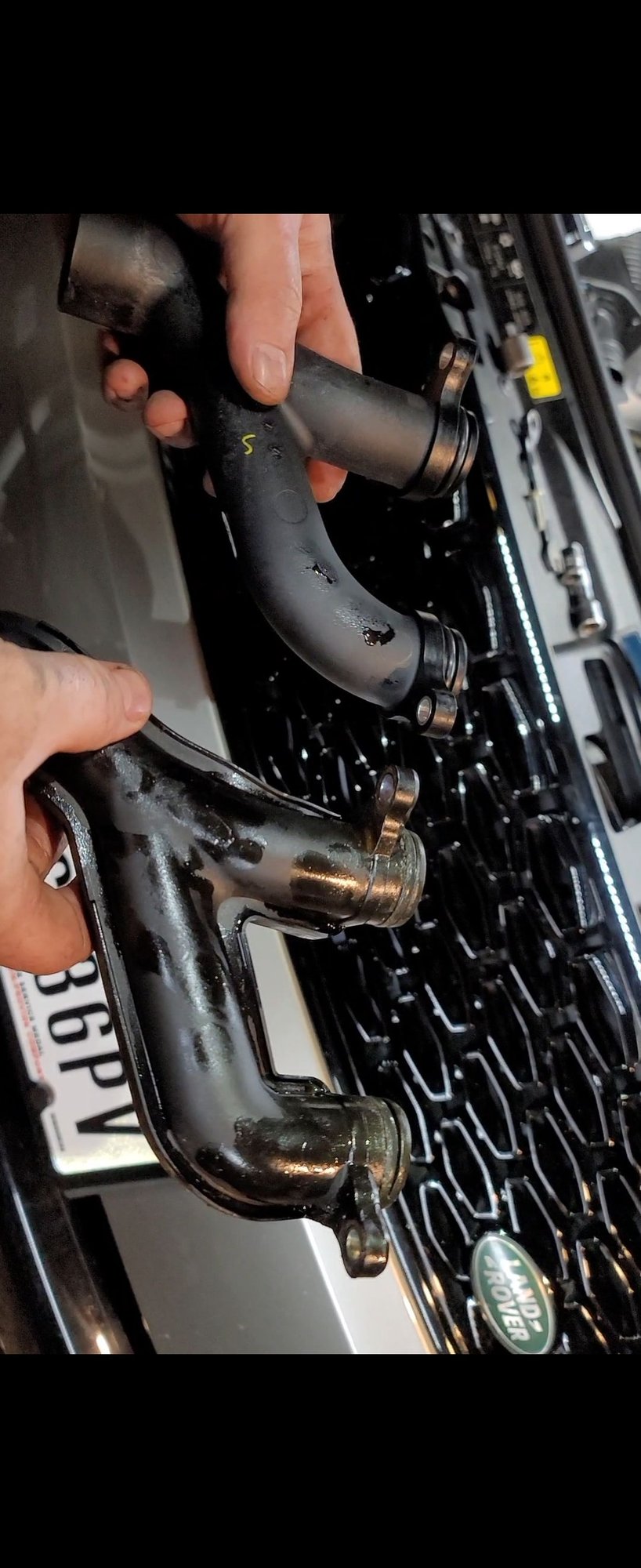

There is an updated version of the front cross over which I used 2 years ago. The shop (who I have known 20+ years and worked over several of my rovers) has tried the aluminum replacements with success. The biggest issue they have seen is with the rubber seals they include. The SM mentioned they never use what was in the kit but replace with LR specific ones.
For part number I find researching through Land Rover Lake bluff parts has helped over the years. They may not have it in stock or over priced but at least I have actual LR part number. Water Pump for 2017 Land Rover Discovery | Land Rover Parts Now (landroverlakebluff.com)
side by side comparison of the old (still wet from removal) front cross over pipe compared to the new design...
