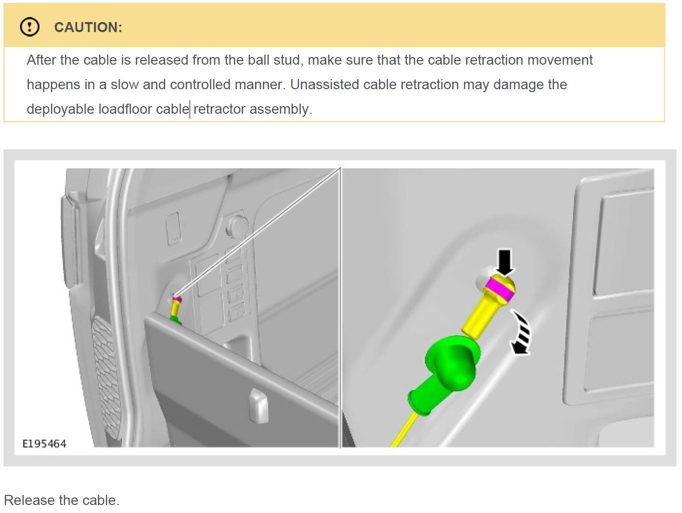

Hi ALl,
Has anyone removed the left boot trim before? I have the section for the workshop manual from Topix but i'm a little confused on removing the deployable load floor cable.
The image show whats in the manual, basically a simple picture and nothing more.
Any help would be appreciated, it's
so I can run the cable harness for the deployable side steps.
Cheers, Andy

I figured this out with some help from the Facebook group, you just push the metal clip up or down on the piece and it will then come off. After that its fairly simple
