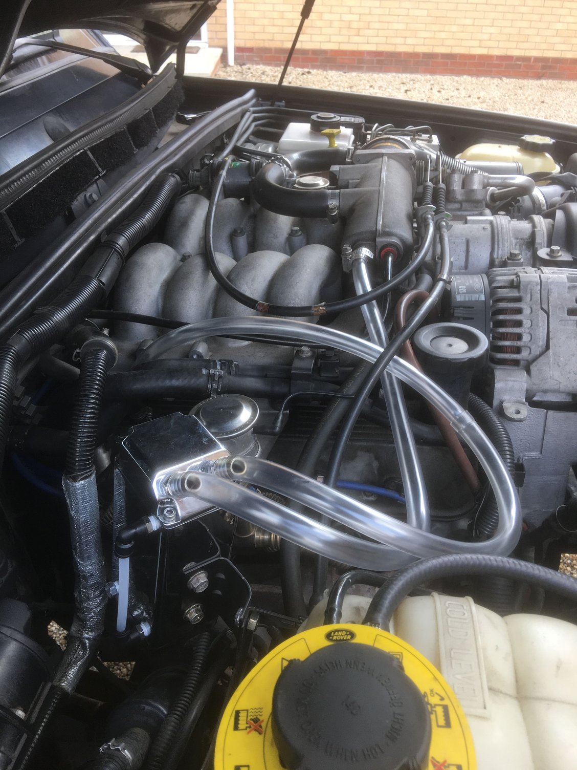

What's this?
"oil catch can install"

I’m going to install an oil catch can on the RHD side of the V8 engine.
I’ve got everything I need for the install but I need to locate a good spot to mount it.

This weekend I installed my modified NRG oil catch can with some left over hoses onto my V8 and drove it for a couple of days already.
It’s still too early to see any pros or cons of doing this for a Disco. I noticed already that I need to add hoses that are more temperature resistant and mount the catch can in a better spot which means longer hoses. For now It’s too close to the exhaust manifold.
I also removed the Best 4x4 PCV valve mod (for now) and reinserted the original plastic valve back into the intake manifold. This was in case the catch can caused more of an air flow restriction.
I’ll give it a month to see what happens and report back.
