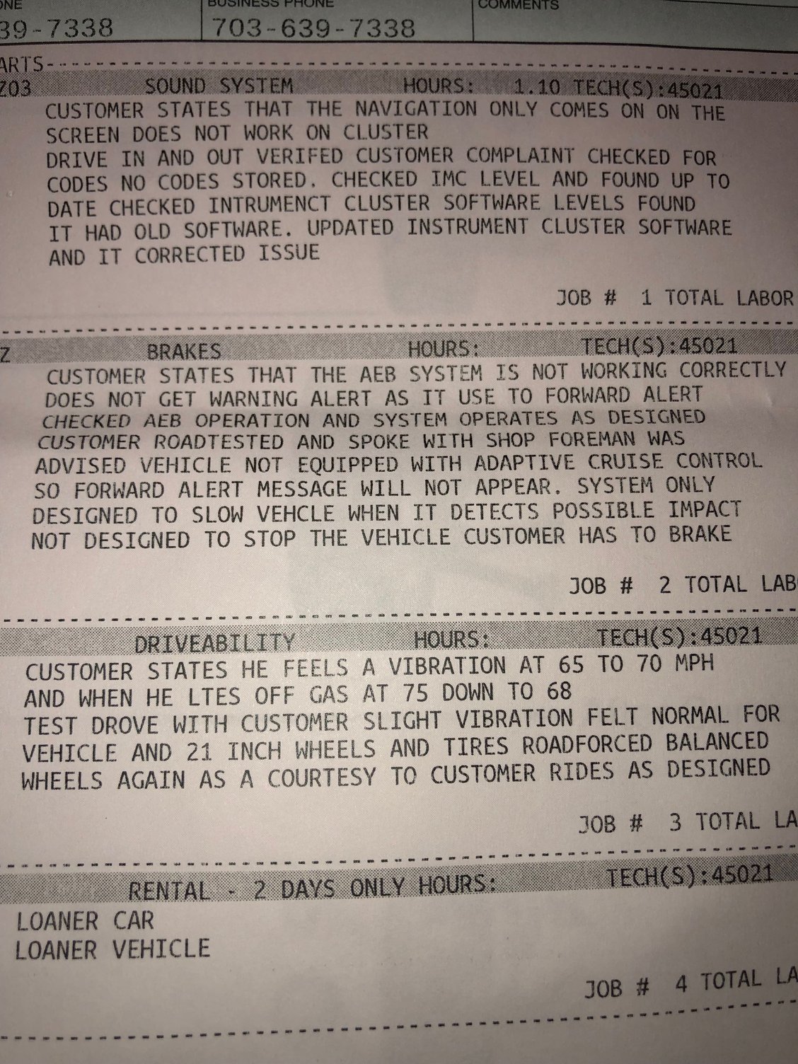

Hi Britcars, many thanks for the input. I will go to the dealer and try to explain the same. What the dealer mentioned few days back was - AEB works only when fitted with ACC and AEB will not work independently which means it will NOT apply brakes automatically in case of imminent collision. The description you provided is from the manual or any land rover website that I can refer to when I see the dealer next week? Please let me know.

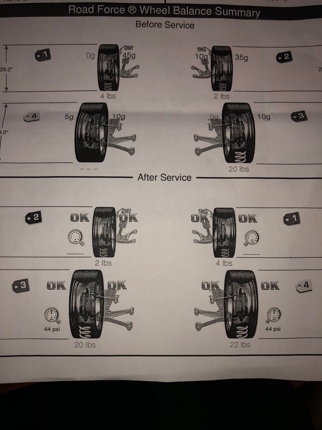

Hi Brit cars, need your input/advice. I just came back from the dealer after my 3rd visit to the dealer in the last 2 months. Went to the dealer for the same vibration issue. So far, my car has been in the work shop for more than a month (if you consolidate all the time frames)
- The last time they changed all the 4 tires they did a road force balance(RFB) test and mentioned that the settings are with in specs. They were able to fix the vibration issue up-to 80%.
- I took the car back to the dealership for 2 complaints - Now, slight vibration between 67-74 MPH and the AEB issue.
- They are giving all vague reasons that the vibration is due to size of the tires and the RFB test came out with in specs (attached the latest report) and the car is working as per the design etc. I even took one of the service technician for a ride with speed limits 67-78 and they observed a slight vibration in the steering. Now, they are saying that all the tests are done at or below 60 MPH(ideal conditions) and not at high speeds like 70 and above. They are trying to spin a different theory every time I counter with facts. Basically, they didn't want to address the issue any more as the engineers are clue less.
- Is AEB dependent on ACC? that's what they mentioned in the summary report which is attached to this thread.
My Q is, these kind of issues if not resolved/rectified by the dealer who sold the car, Is legal route an option? I never had an experience or been in a situation like this. Appreciate your input.
Thanks,
Rsquare
