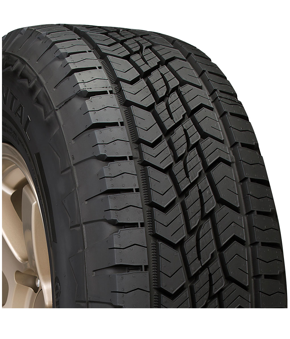

Loved those Terra Grapplers on my Pepper when I had it. I think I may try those new Conti ATs when we finally get our Disco. A little tamer AT tire but we are both 60 now so doubtful I'll be doing as crazy of stuff and should have better road manners for the wife. Terra Grapplers did surprisingly well though on the highway.
Tire **** . . .
