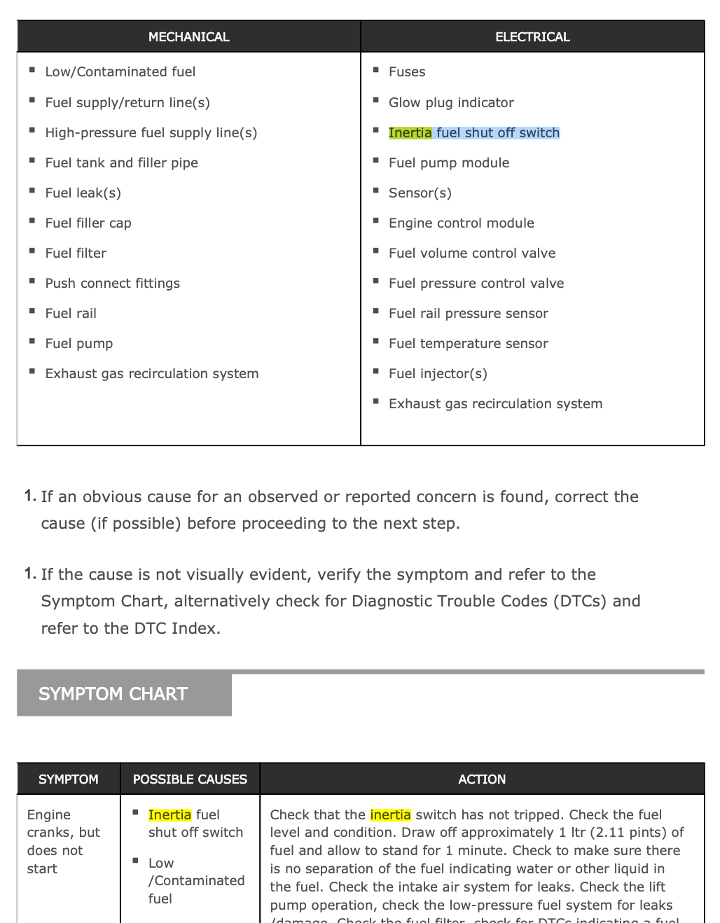

I have cleaned up every ground and still running into it turning over but not starting. Is anyone aware of a fuel reset switch/ inertia switch in this model? The workshop manual mentions it but doesn't have any other information on it.

I found that same reference to the inertia switch but it was under the TD6 section, not under the Si6 section so I don't think that will help you.
I also could not find any reference to a fuel reset.
Inertia switches are used primarily for accidents to cut fuel delivery for fire prevention. I'd especially expect one in gasoline engine equipped vehicles.
Yeah I would have to think there has to be one. My symptoms are replicating the litany of previous discovery models having this issue. Someone hopefully can chime in and let us know.
