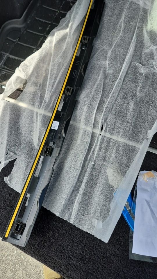

Had a photo of the back of it sent to me. Looks like it clips into a few placed up the a-pillar and also has a thin adhesive strip down one side.

I just did both sides yesterday. Behind each number is a clip. They are kinda frail so be careful when popping them in. Pull the tape cover first. If you try to pull it after you install it, it'll rip and be clipped and partially struck on.
The previous people decided to use the same windshield adhesive to epoxy in both side of this retainer on mine. I had to chisel off the passenger side which wasn't fun.

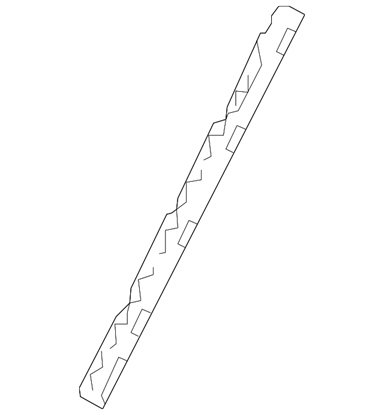

I don't see any separate clips for the moulding and finisher in the parts diagrams. The moulding plate attaches to the A-pillar and the outer finisher snaps onto the moulding plate. It looks like if the clips break the intention is the whole parts are replaced.

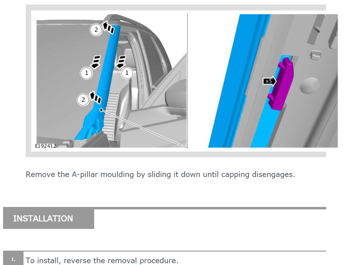

The outer finisher/capping looks pretty easy to get off. Slide down to release the clips and pull off. I'm still looking for the mounting plate in the manual.
I had a good look though the service manual and was not able to find the mounting plate referenced anywhere. Provided you have replacement ones you will be able to tell where it clips in to pry the old one off.

The numbering on the mounting plate was initially baffling to me. Is it possible each number is right above the clip to the A-pillar and that's the order you're intended to pry it loose with a trim tool?
