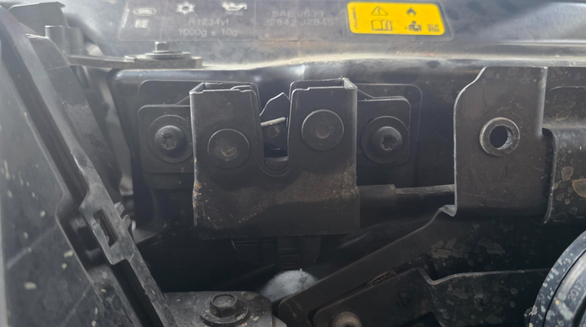

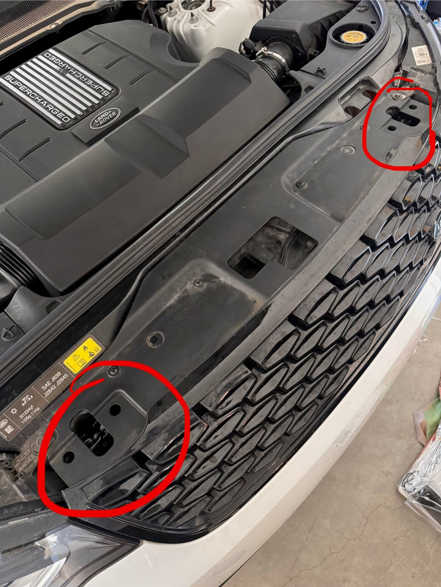

My hood latch was getting increasingly harder to pull, not releasing the hood until the end of the throw. Was shopping for a new cable & decided to spray some silicone on the latches.
Surprisingly, the latch functions like new again & releases midway through the pull. Seems obvious - but all threads I searched just recommended replacement.
Locations in photo below.

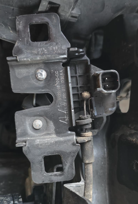

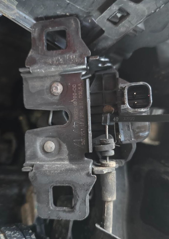

When I looked at the cable end by the hood latch, there was a bit of free play before the end actuated the latch. Maybe try putting a zip tie there to take up the free play and act as a spacer?

Zip tie... you have got to be kidding me. You, sir, are my hero for the day. Ten cents and less than 30 minutes. It took longer to realign the latch and get the hood level again than it took to fix this.

That’s awesome!! Quick and easy fix. If the cable end ever breaks, it wouldn’t be hard to crimp an end on there too. Well done!
