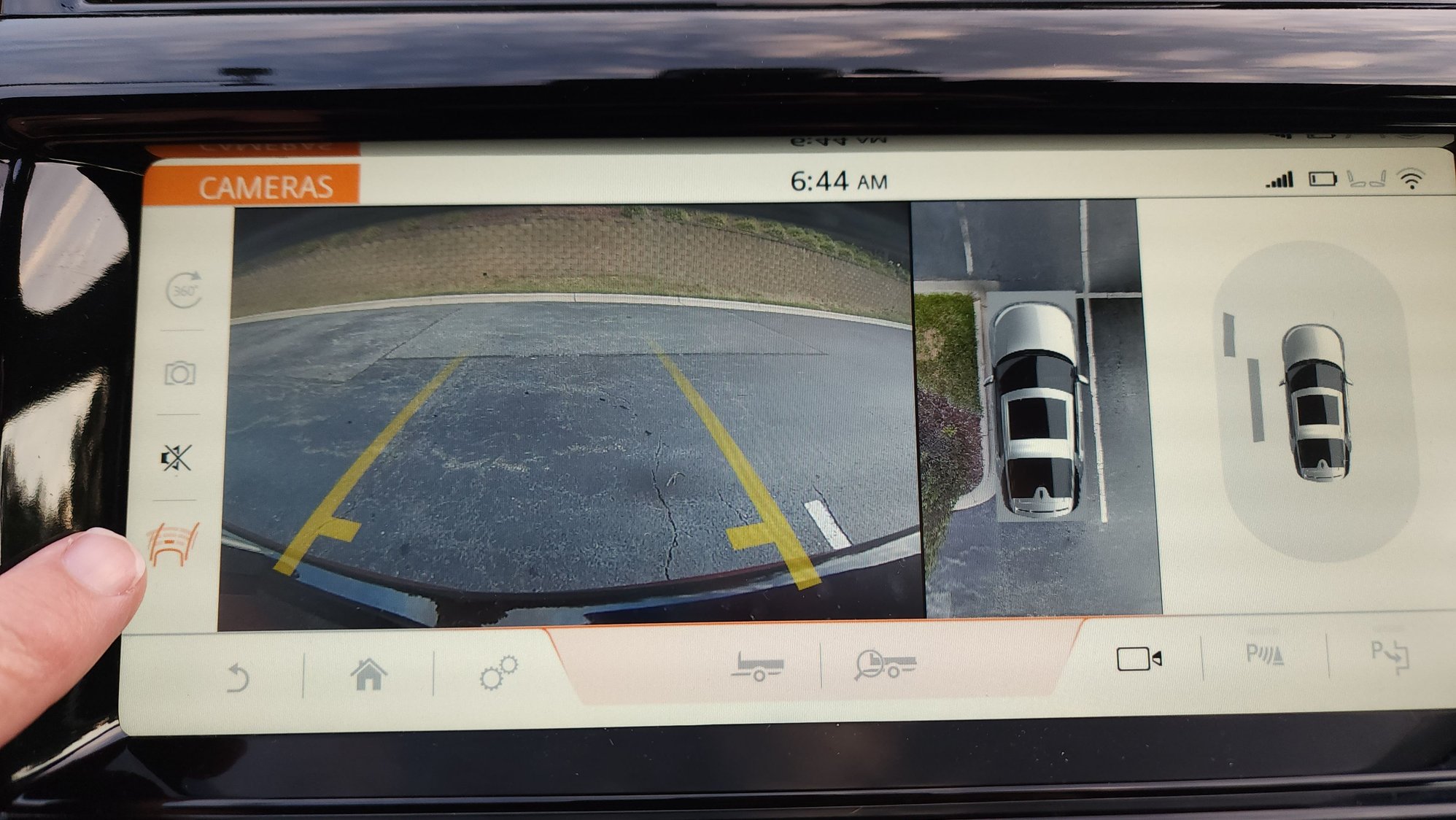

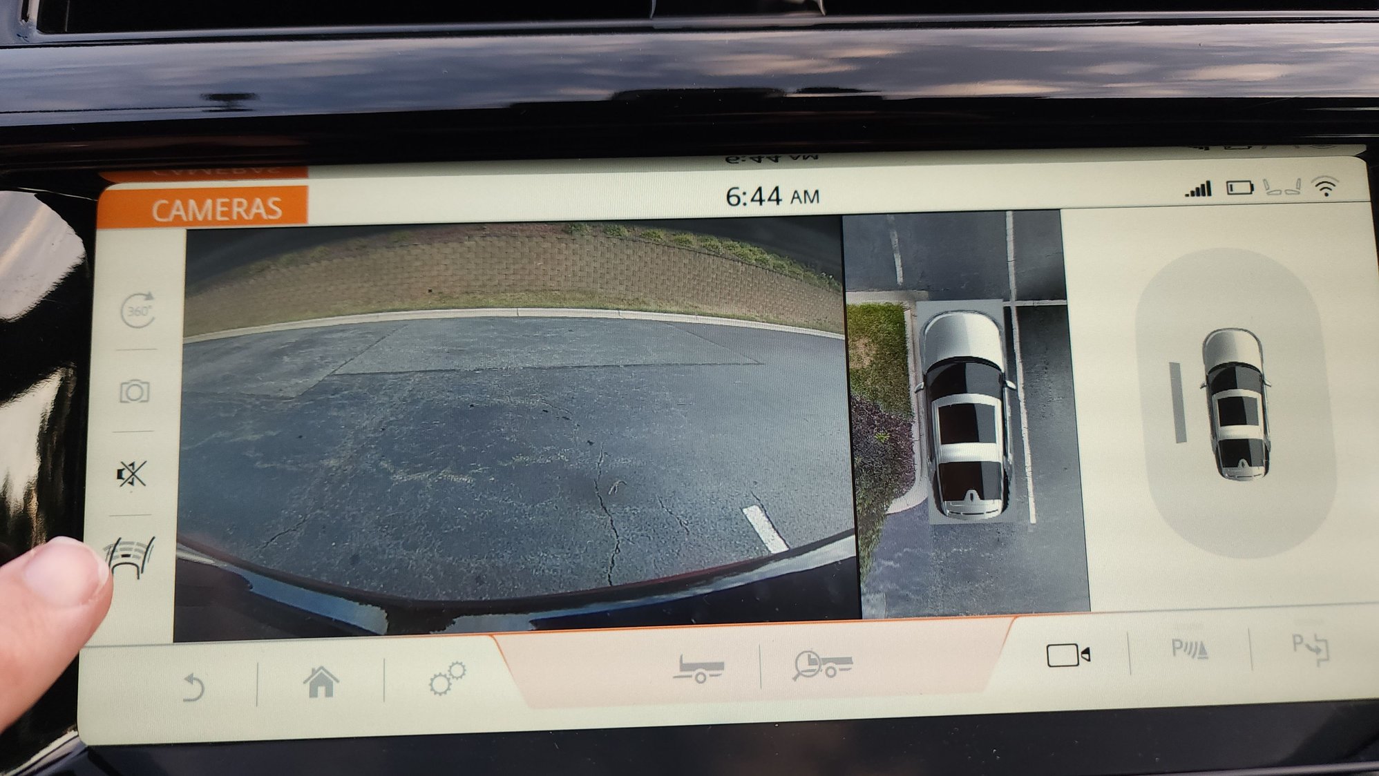

Hello all! Just picked up a 2019 Discovery V HSE which I’m loving so far (retired my 2010 LR4 with 300k). One small issue compared to some others I test drove is I’m not seeing the yellow lines on the backup camera.
I have a new GAP IID tool arriving soon and I’ll check for codes, but haven’t see any other error messages.
Anyone know how I can activate those lines or if there’s a problem? I figured the button on the left side should turn them on, but it doesn’t, I also don’t see anything in the camera settings.

I had the same issue and my resolution was tapping the lower left icon in your picture. Looks like you did try that.

Your parking guidance is turned off, go to camera settings and turn it on.

I figured it out... put the car in reverse, then tap the lower left icon.

In your photo, the "parking finder" light (lower right of screen) is lit. This mode is for locating a parallel parking spot the SUV will fit in. Tap the button next to it - the P with the radar lines. That turns on the parking assist lines for regular parking.
thanks for the responses all, @Elzot I do have this button selected, is it a different one I should be selecting?
I also checked the codes, I see the one below, anyone know if this is responsible for those lines?IPMB-Image Processing Module 'B'
  • U2300-56 (6C) Central Configuration - Invalid / Incompatible Configuration
In this picture, the correct button is selected. I see the screen is otherwise a bit different in mine. I don't have that other rear "track" icon on the left.

Nope. i have the same problem as OP. U2300-56 and no tracking lines. I can select, unselect whatever i want - no lines.
Funny part is that tracking lines shows up at camera view for few seconds after ignition on.
I tried 'As built' CCF upload, checked all camera and parking aid related settings, in some cases i just lost cameras completly, but nothing helps,
