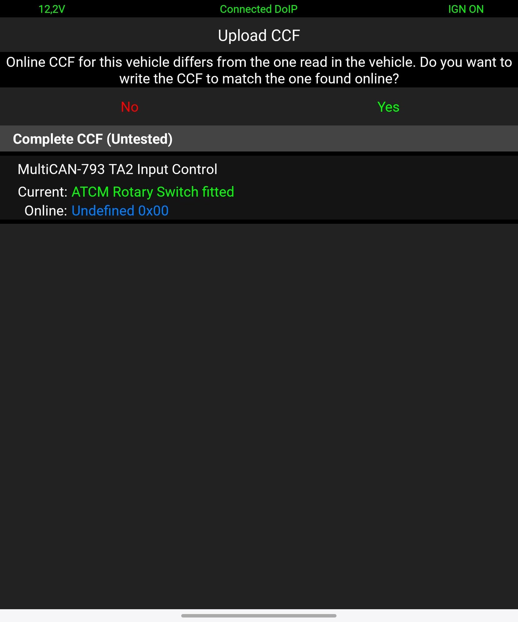

I have finally fixed mine! I spent about 500 Eur but it works. Expensive, but it took few days, and LR factory was involved, but i'm happy it works again.
Dealer said there was mistake in central database ruring move from pathfinder to topix.
this is only difference after dealer fix.
Looks like trailer assist was the issue. Try to set it as below and give feedback here.
MultiCAN-793 TA2 Input Control
Change to ATCM Rotary Switch fitted
Originally was Undefined 0x00
iidtool

I'm not really adding anything to this, but I am new the LR fold with a 2019 Disco HSE Lux. Only has the backup camera (no surround view). I only get a single yellow line centered in the display with reverse is engaged, not the 2 lines depicting the wheel width as I am used to from other vehicles. I haven't seen a way to change this. Just and observation.
Old May 8, 2025 | 09:09 AM
jimmie86's Avatar
6th Gear
Joined: Feb 2025
Posts: 6
single line is tow hitch assist to help connecting trailer. in camera settings you change that.
