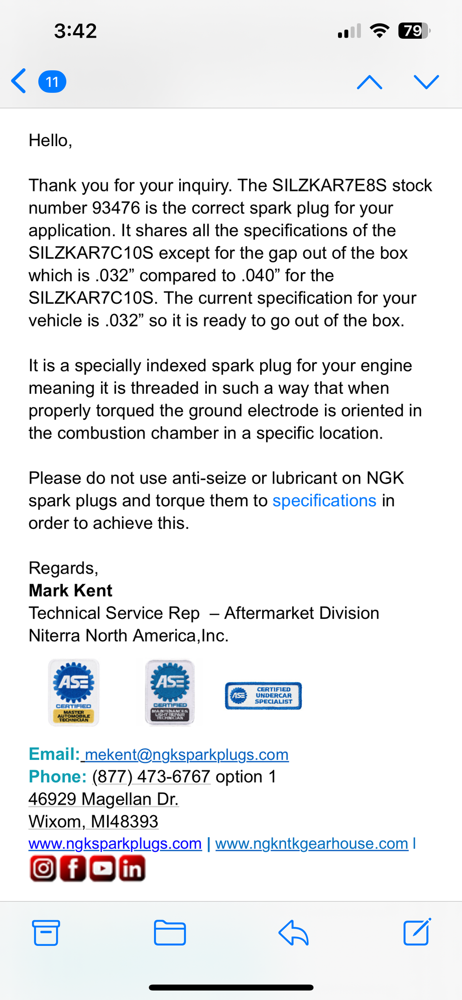

Surprised there is no other mention of spark plugs in this forum! Perhaps very few bother with anything other than the OEM ones from the dealer. Can anyone confirm if the OEM Land Rover ones in our cars (Si6) are actually this NGK one below? The 93710 quoted above has a heat rating of 8 while this one is a 7 which is what the auto sites show as the OEM replacement. I don't mind saving a few bucks buying the equivalent NGK one instead of ordering from the dealer. I wasn't sure if the .032" gap listed for these is what the OEM plugs are..
NGK 93476

Just give the dealer a call they can verify the gap, you can check it......... my experience with NGK from Rockauto, has been 100% correct.

Here’s what I found out from NGK earlier this year. This is for my 2017 Si6.
