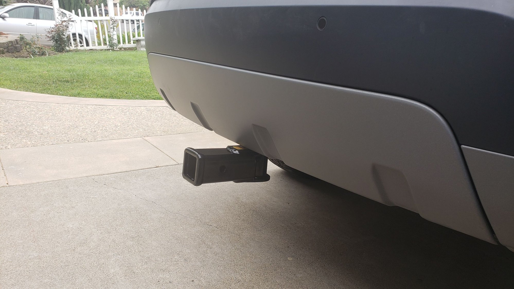

Just installed one... It took 4 weeks to get it from Stealth and they say it is a 2 hour install on the hitch in their paperwork but it took 4 hours for the Uhaul guys to install it... and they do lots of hitches in our local area - lots of audi and bmw hitches. The guy said there were more nuts and bolts off the darn truck then he ever had seen - but he thought it was the coolest hitch around.
They also sell a 'towing' package with a second receiver and wiring harness, but I just looked under the truck and it appears that the truck is prewired for a 4 or 7 harness right at the back.
Just an example of the ride...
Yes, there is a hitch assembly there
This is the receiver that fits UP into the hitch assembly
This is what the hitch assembly looks like from the bottom
This is the stealth hitch installed
This is how it looks from the rear when installed
This is how it looks from the side installed
Here are what I believe the 4 pin and 7 pin wiring connectors are just behind the cross member on the drivers side. easy access

The cost from Stealth was about $750 for the hitch delivered with only the 'rack' package and I am going to get the tow receiver separately for around $120 from them. WE can put in a standard square receiver but their warranty doesn't cover it - and I want them to have the liability risk if it were ever to come apart while towing. Also, the 'rack' kit does not come with a safety chain connection point (so I need to create something for that - and their hitch replaces the ****** hook for towing/recovery as it was on the frame piece that their hitch replaces. (learning new things all the time!)
Installation took 4 hours at the Uhaul place - and they charged me $360.

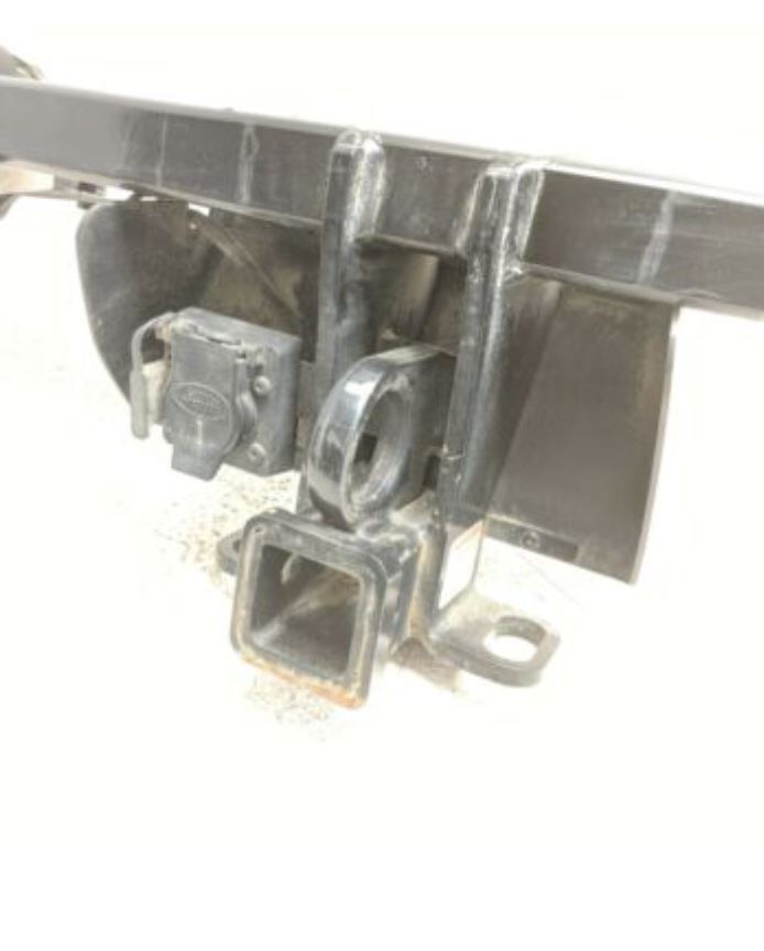

It is not really 'points'... what there was was a steel loop behind the cover plastic that was welded into the safety cross member on the standard truck. The hitch receiver is what i am using to replace it:
Amazon Amazon
The Stealth replaces that standard cross member with their own bolt on and IT does not have that loop... So, my alternative has been to get a Hitch Receiver and D Ring Shackle that goes in the receiver...
Now, the factory setup has the loop as a part of the hitch system for the US models.
OEM Hitch
And the towing safety hooks (which the 'rack' model from Stealth does not come with - but you can order the 'hitch' model for a $300 more - which I did not do)
I'm going to put some soft loops on the cross member to satisfy the safety chain loops.

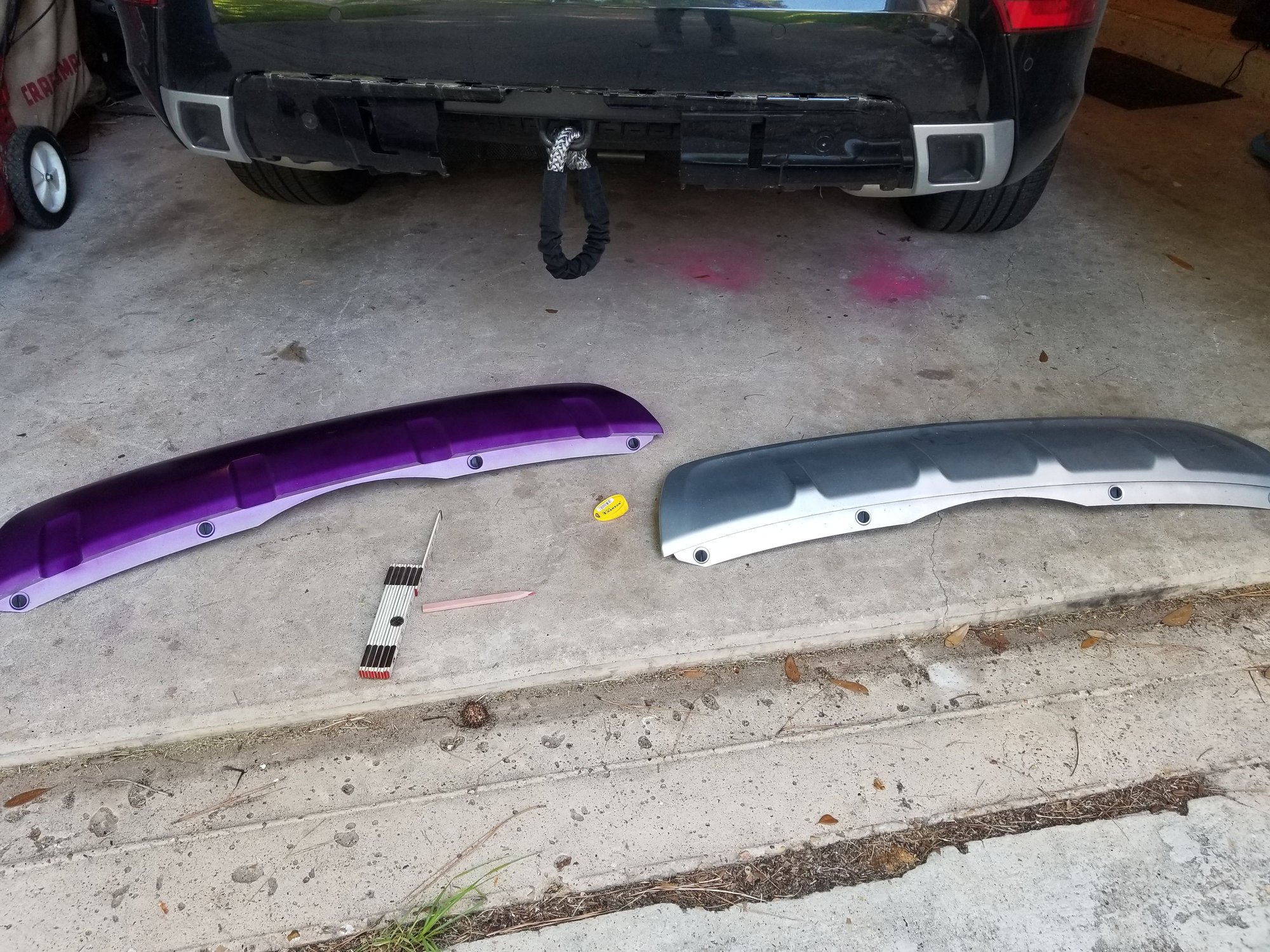

Pictures i have of Discos that may help. Some are mine and some are not... and yes... spare offroad cover is purple... to match our offroad wheelset and winch stuff
I do like the stealth for it not killing body lines and bumper when not in use.
I cut a spare ebay junkyard plactic cover ($65 shipped) to access my recovery point as well.
