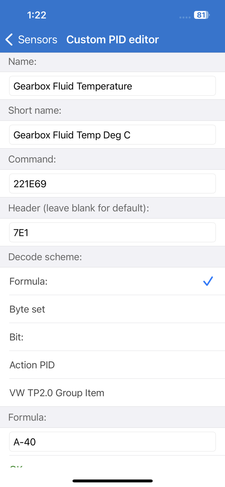

I used the app Car Scanner on my iPhone and added tha PID for Gear Box Temperature and with the Header changed to 7E1 it worked great.
