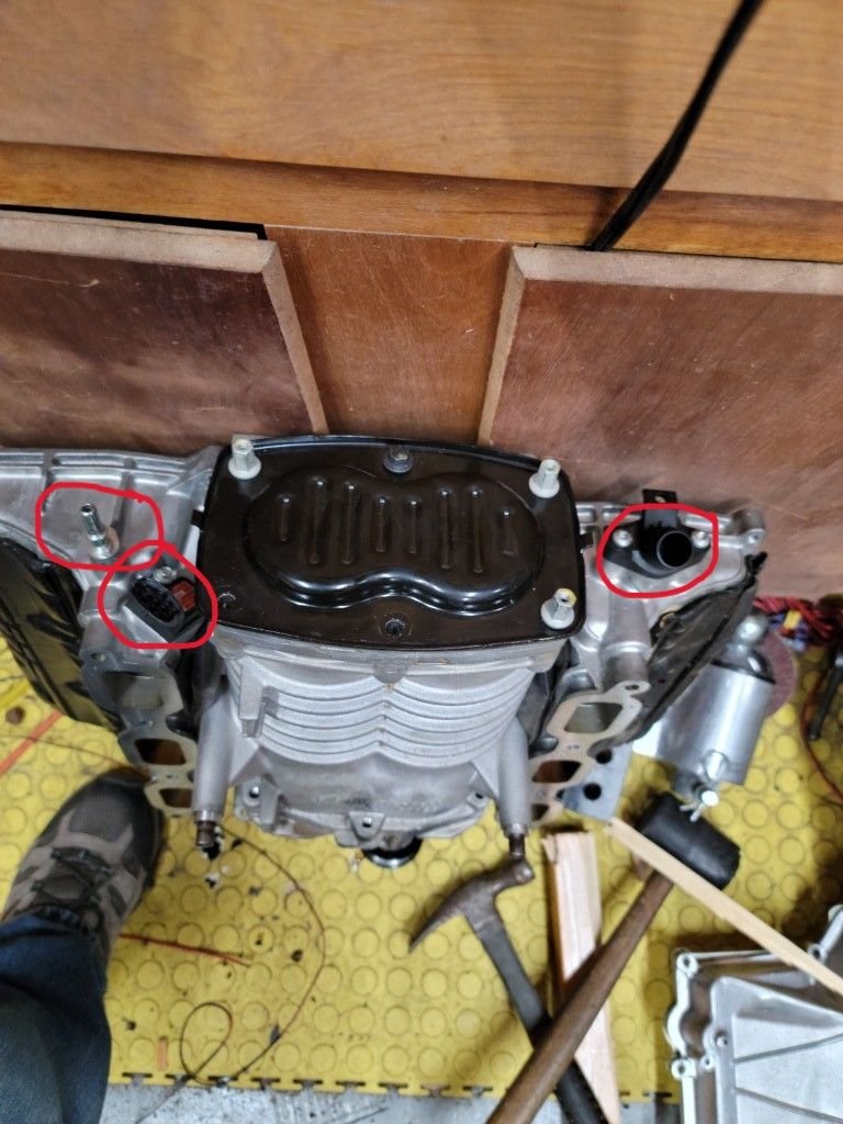

Originally Posted by Donc98
Sure. I needed to remove all supporting bolts (1,2,3) at the told of the SC. Be careful with these on reinstall as the aluminum threads are soft where the bolts go. I disconnected the hoses going to the throttle body as well as the electrical connection listed as number 15 (goes into the top of bypass valve). Now the hard part is not shown. Part number 7 has an electrical connection that you have to pull off. I was able to get my hand back there and remove it but it was hard to see. the 4 coolant lines will need to be removed and placed out of the way. Also plan on replacing part 13 the gaskets and that should be about it. Here is a picture of the back of the SC that will give you an idea of the connections there. The one on the right I am trying to remember if anything was connected. I don't think so as it was a drain tube. Also I did not have puller system that has been mentioned in some write up. Summit sells one for about $100 for supercharger system. I just used a pry bar around several point around the engine to gently get it lifted away. Be careful of course not to leverage against any plastic bits
when doing so.
Okay a few more questions please:
1. It appears you removed the entire supercharger in one piece and did not separate it from the left and right intake manifolds (nos. 9 and 21), nor from the charge air cooler tank top (no. 4). If this is the case then you didn't need to replace gasket number 5. If this is correct aren't some of the screws 1, 2, and 3 not going to be removed? Maybe just remove the longest ones (nos. 1 and 3)? Does the charge air cooler tank top (no. 4) have to be separated from the left and right intake manifolds (nos. 9 and 21) in order to reach screws that fasten the left and right intake manifolds through the gasket (no. 13), to the top of the engine? You said you replaced gaskets (no. 13) but the description fo 13 is a vibration pad - so is this item actually creating a seal?
2. What parts were being separated when you used a prybar instead of a puller? Removal of the pulley isn't necessary is it?
3. Once the supercharger with attached charge air cooler tank top and intake manifolds is removed, will the rear crossover pipe be ready to be removed and replaced?
Thank you for your help Donc98
