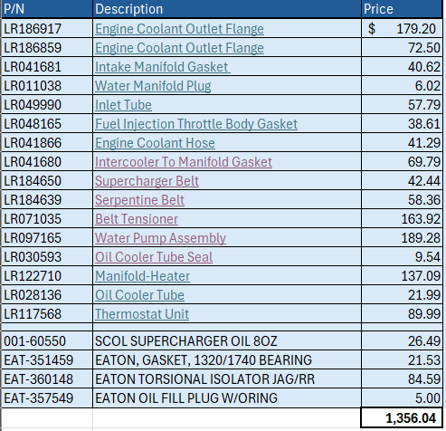

Hello everyone, I am planning to do the coolant upgrade over the holidays ( either Thanksgiving or Christmas ). This is the list of what I've bought to get it done. I'd like to know if I am missing anything. Re: 2018 LR Discovery HSE - SC Gasoline [ 71,000 miles ]
Thank you in advance!

Don’t forget coolant. They make an aftermarket aluminum thermostat assembly. Not sure if some of your LR parts are plastic and available aftermarket aluminum.

Here’s what I posted previously
Besides gaskets, the original repair used:
011038 Water Outlet Plug
049990 Tube, Thermostat to Engine
033994 Tube, Water Pump to Thermostat
045239 Throttle Body Heater Hose
The above parts are Genuine LR
090630 Tube, Coolant to Upper Hose
092992 Coolant Outlet Pipe
117568 Thermostat Assembly with sensor
122710 Crossover Manifold Rear
The above 4 parts were Metal by Euro Amp brand
The failed parts were:
And were replaced with genuine LR parts which weren't available at first repair:
186859 Tube, Coolant to Upper Hose
186917 Coolant Outlet Pipe
The following 2 metal Euro Amp parts were not available in metal from LR and were not leaking after the repair so were not replaced during second repair:
Note:
When using aftermarket metal parts, the genuine LR O-rings were used. Don't use the O-rings that come with the aftermarket parts.
I bought 1 gl of Genuine LR Coolant. I haven't check if 1 gallon is enough.
The 2 coolant outlet pipes [LR186917 and LR186859] are Genuine LR aluminum parts.
The Rear coolant manifold pipe [LR122710], Oil Cooler Tube [LR028136], and Thermostat Unit [LR117568] . . . all Aluminum, are from Euro-Amp.
Everything else is Genuine Land Rover parts, and OEM EATON replacement parts for the supercharger.
Do you happen to have the part numbers for the LR OEM O-Rings? * The 2 outlet pipes already have the O-rings.
Thank you for the heads-up.

Sorry no part number for O-rings. 1 Gallon Genuine coolant will make 2 gallons mixed with distilled water. That is plenty. I was told both by the dealer that I trust and the independent that I trust that LR O-rings should be used on the aftermarket parts.
