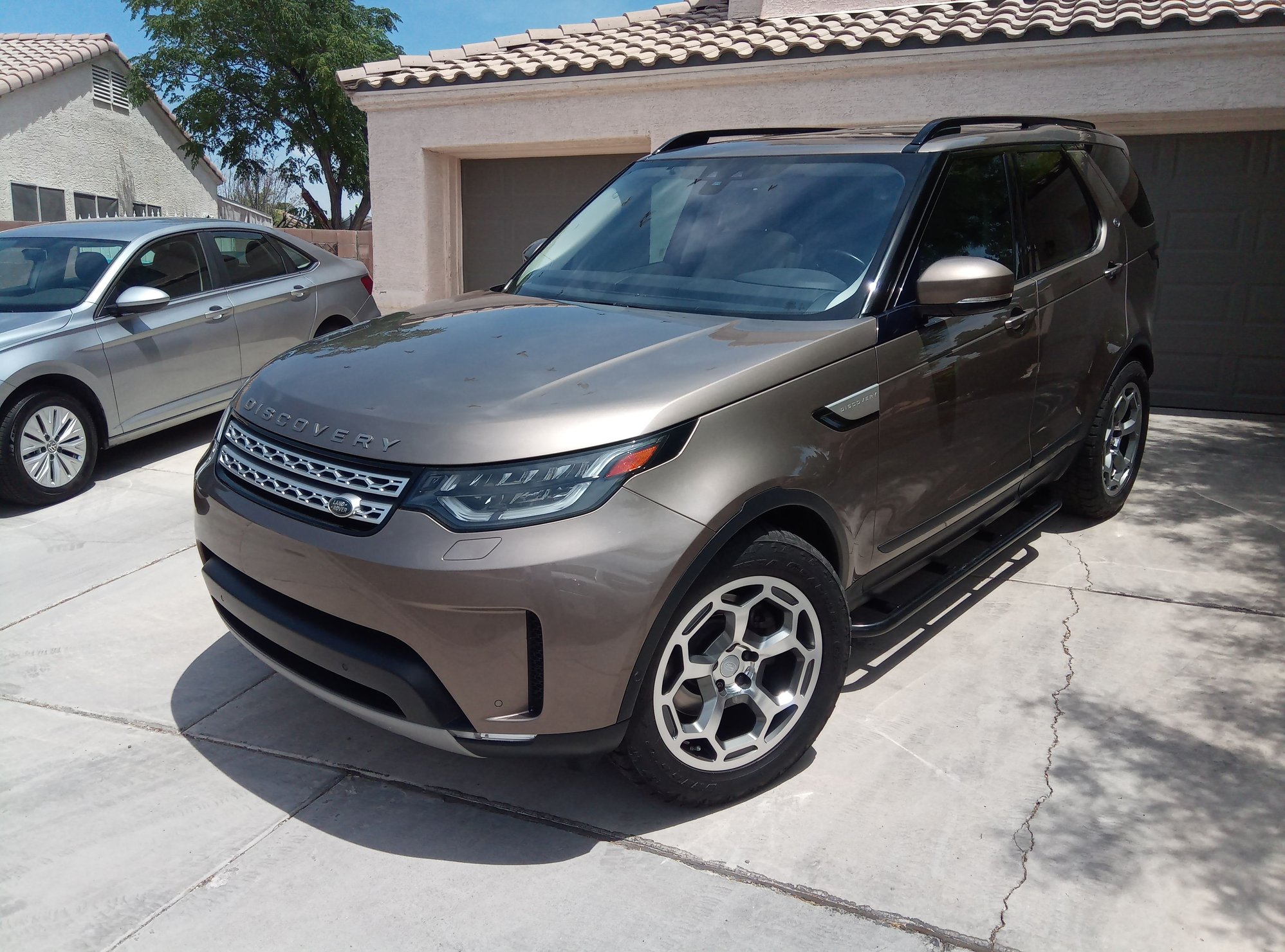

Installed a set of TerraFirma 30mm wheel spacers on the D5 yesterday. I definitely love the new look. I didn't think 60mm wider track would make much difference in the way the truck drives, but I can definitely feel it. Mostly on the backroads near our house where it just feels more stable around the curves. I also programmed in 20mm lift with my GAP tool. I'm not sure how this would work without a lift. It might be ok, but when the suspension settles down in entry mode there's only 2 cm or so between the tire and the fender flare. It's especially close when the rear drops again after opening the tailgate where the gap disappears down to a couple mm. Tires are 265/65R-18 Kuhmo Road Venture AT52 which are close in dimension to the stock 20 inch tires we took off.
These pictures are at the stock non-lifted entry height.
Before:
After:

Looks good! What wheels are those?

Those are the TuffAnt Simpson 18" wheels. I'm actually replacing the front spacers with a 20mm spacer soon. 30mm causes the tire to rub slightly at the front of the wheel well liner only while reversing. I guess there's enough flex in the suspension bushings to move things around a little.
