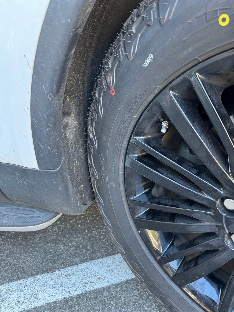

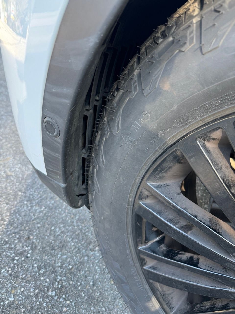

Just had a new set of Wildpeak AT4W installed and they are rubbing quite a bit, even without maximum turn and rubs both front and back of the wheel well. Also seems to be worse at offroad height. Any suggestions, I thought 275/55R20 was safe.

These are the standard tire sizes. You seem to have an additional .5" of sidewall
check https://tiresize.com/calculator/ to compare

I run the AT3W's in LT at 275/55/20, but already had Johnson Rods/lift installed on my vehicle when purchased. No rubbing.

I knew they weren't a standard size, from reading the forums it seems 275/55/20 works except for super aggressive tires that are out of spec. Guess I should have gone with one of the proven ones.

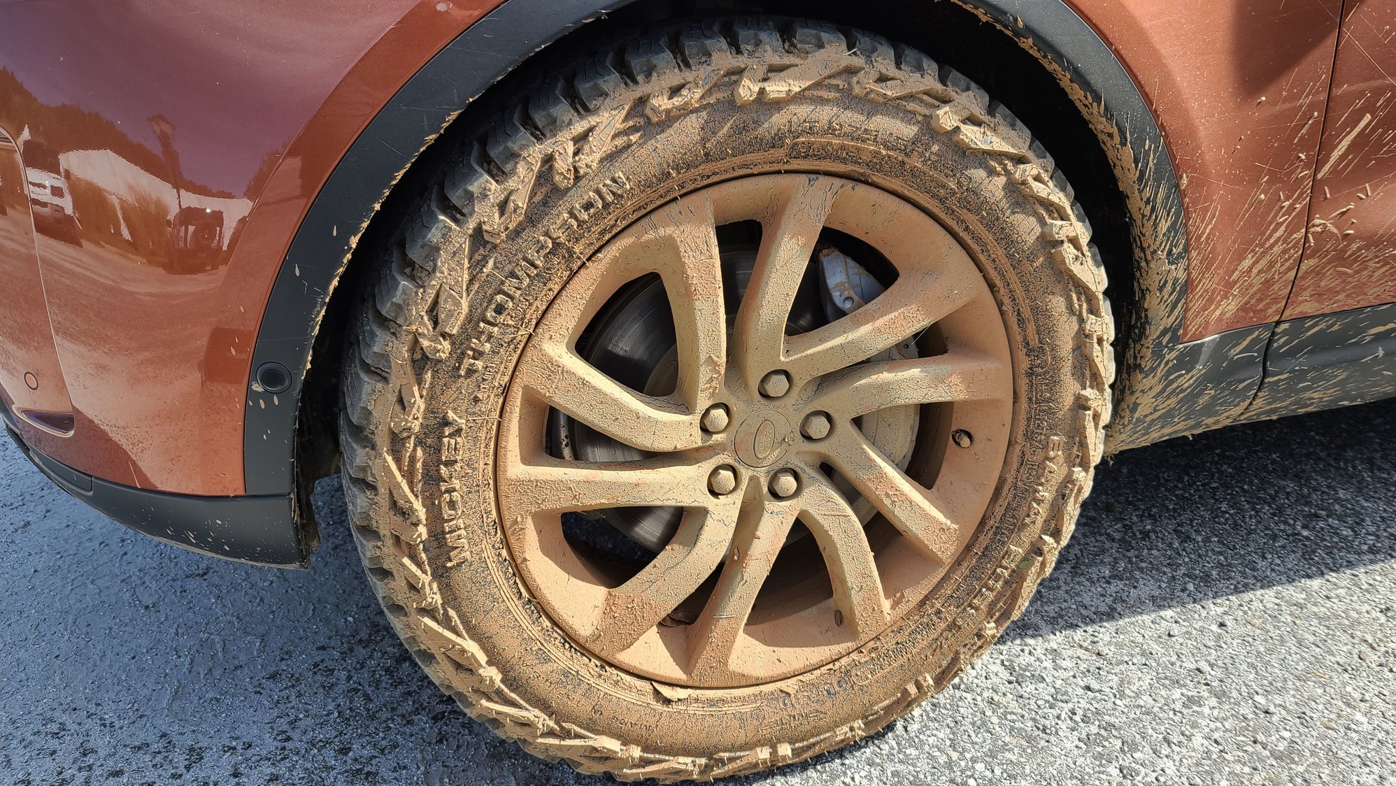

I run Mickey Thompson Baja Boss AT 275/55/20 with no rods and have zero rubbing. I do put Lucky 8 rods rods on when I hit the trails (I have all 3 lengths), but switch back to the OEM standard for pavement since it only takes 5 minutes.

It seems, I just got really unlucky (read stupid), AT3W 275-55-20 seem to fit as do many others, but not the AT4W. Now I need to find a way to unload them without taking too much of a hit.

Probably just me but those tires look a lot shorter in the sidewall than I'd expect from a 275/55R20. Are you certain of your wheel/tire combination? I run 275/55R20 Goodyear Duatracs and they're pretty aggressive (and noisy) and have had no issue. Could just be perspective in the photos

You had me second-guessing myself but I checked, it is indeed 275-55-20. Partner declared situation was unacceptable and to get tires asap, so I ended BFG Trail Terrain in 255-55-r20. I didn't get to do much research, had to pick what was in stock. I'm already having nightmares of multiple flats and sidewall rips.
