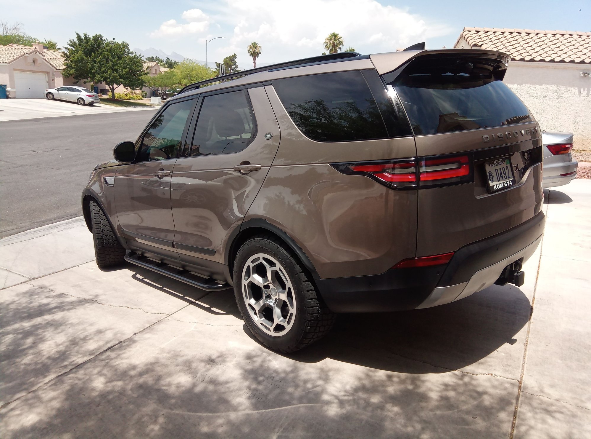

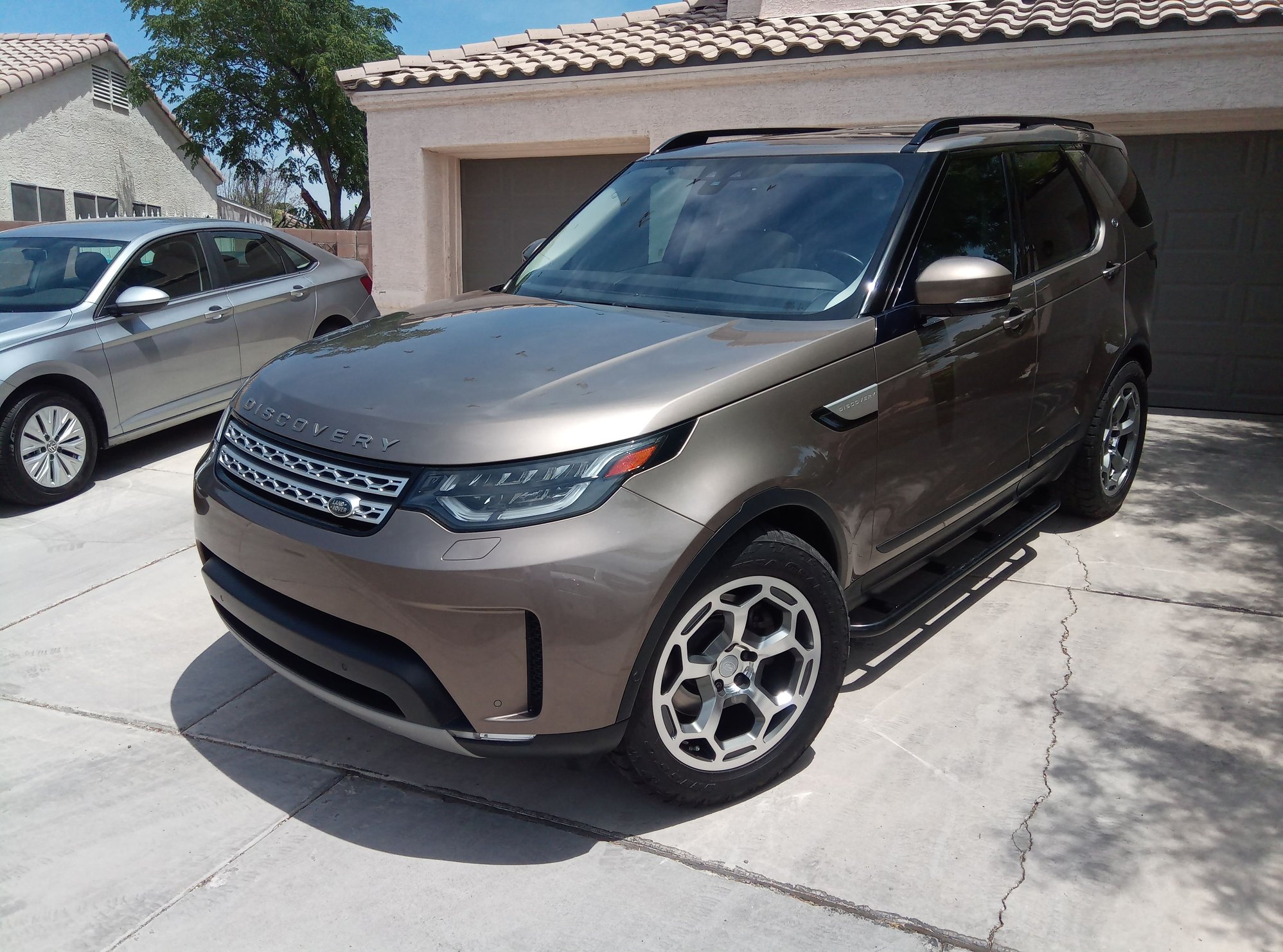

I have 285/50-20 Nitto Terra Grappler G2s on 20" x 9.5" Redbourne wheels (OEM wheels were 20" x 8.5"). No lift and no clearance problems or rubbing at any height, including ease-of-entrance (lowered) and off-road (raised).
