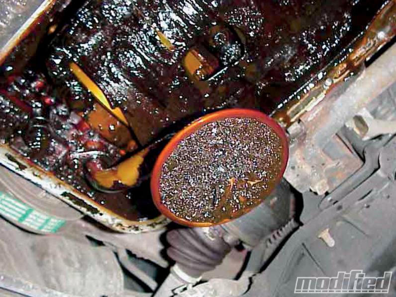

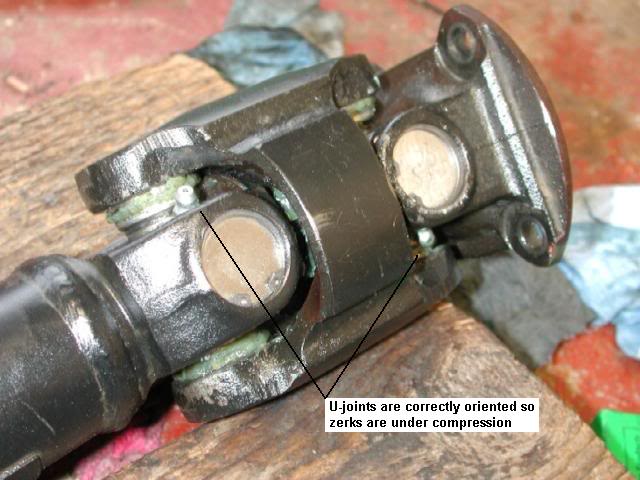

Please review the front prop shaft, if stock it can split and spear hole in tranny. Rebuild or replace with one that is fully greaseable. Pix of the knuckles where fitting are not from factory. Look at one of the 180F soft spring thermostats also. As for oil, if flush products available in the US are not common, like "Gunk", "BG", etc.; consider using transmission fluid in the oil at a 50/50 mix and idle for 20 minutes, then drain and replace with fresh oil. Some even drain oil all the way, keep old filter on so there is a little oil in the system, and fill with ATF and do the warm up and drain flush. Some use kerosene in various mixtures, like one or two quarts to the rest of the oil system. But I would suspect that some brand of oil flush would be available in many places, even if you have to buy it from the dealer. When doing the flush, don't run engine under load, just idle.
You should consider that if oil was sludge, oil pickup screen could also be somewhat blocked. If you drop pan, it can be cleaned, and the pickup tube O-ring replaced, and the two bolts that hold it put back with Locktite.
