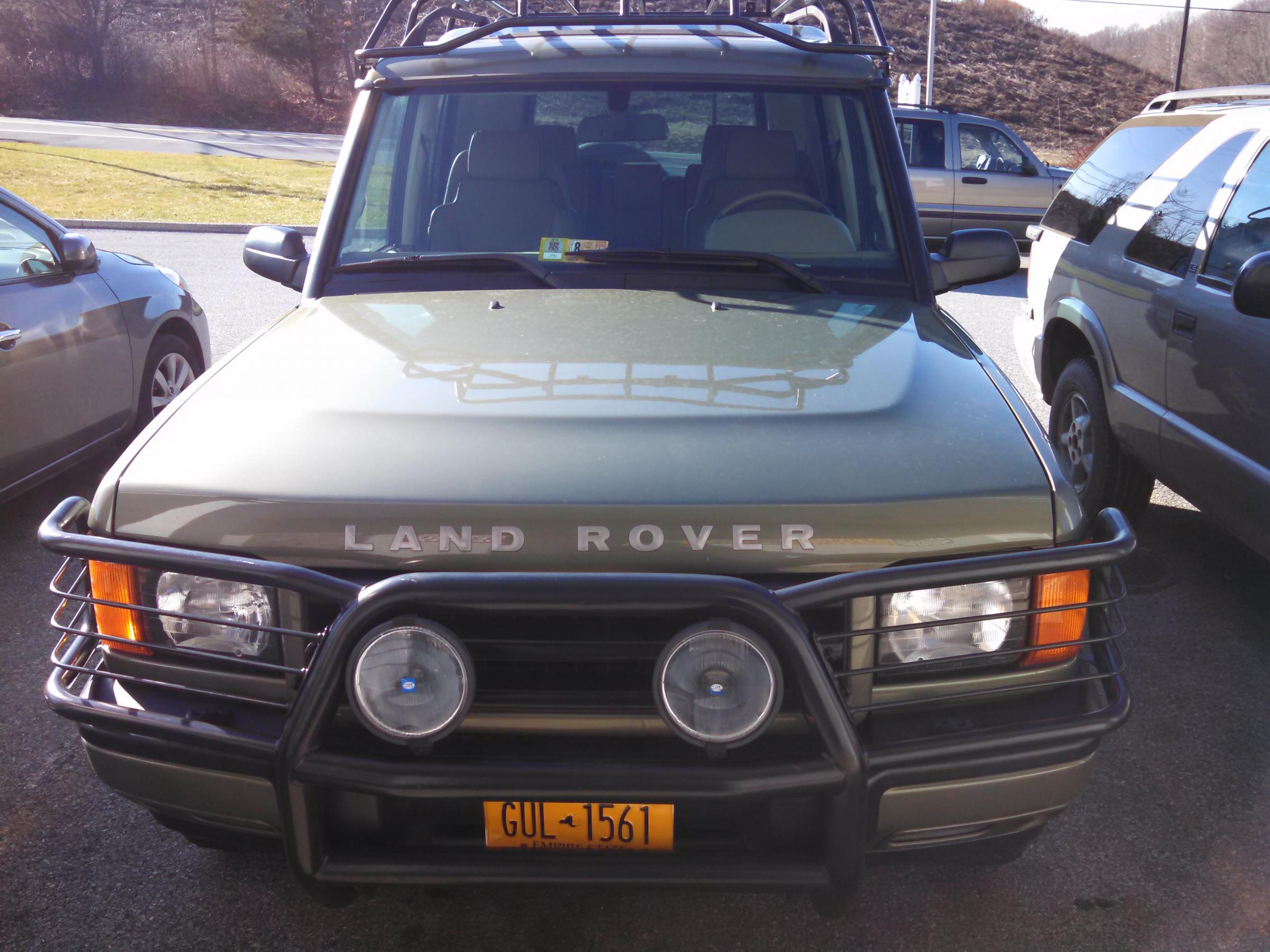

I just purchased a 2001 Discovery that was in Texas for most of its life. It has 111k on the clock. I hope to build it as a weekend warrior for exploring the Northeast with my girls.
There is almost no exterior rust and the frame is really clean. The interior is really filthy and needs a good detailing, and the only issue that needs immediate attention is the leaking front sunroof which pretty much destroyed the headliner. It is falling in and rotted, so I hope to remove it myself and have an auto upholsterer make a new one and install it as I haven't found a new replacement liner to order. I'm debating just siliconing them shut as I probably won't use them and I don't want to have recurring leak issues.
I bought the vehicle sight unseen (I know) and the seller didn't mention that... There's a bunch of missing or broken plastic parts on the interior as well, but I'll source them from a parts car eventually.
The truck drives fine and just had new heads and gaskets installed as well as new plugs, wires, and brakes.

The sunroof is one of two things. Either the drain tube nipples have broken off the tray, or the flange seal that sits against the roof is toast. The drain tube is an easy fix with some waterproof epoxy and a few minutes, and resealing the flange with clear silicone will sort out your sunroof leak woes. Either way, you'll need to drop your headliner.
