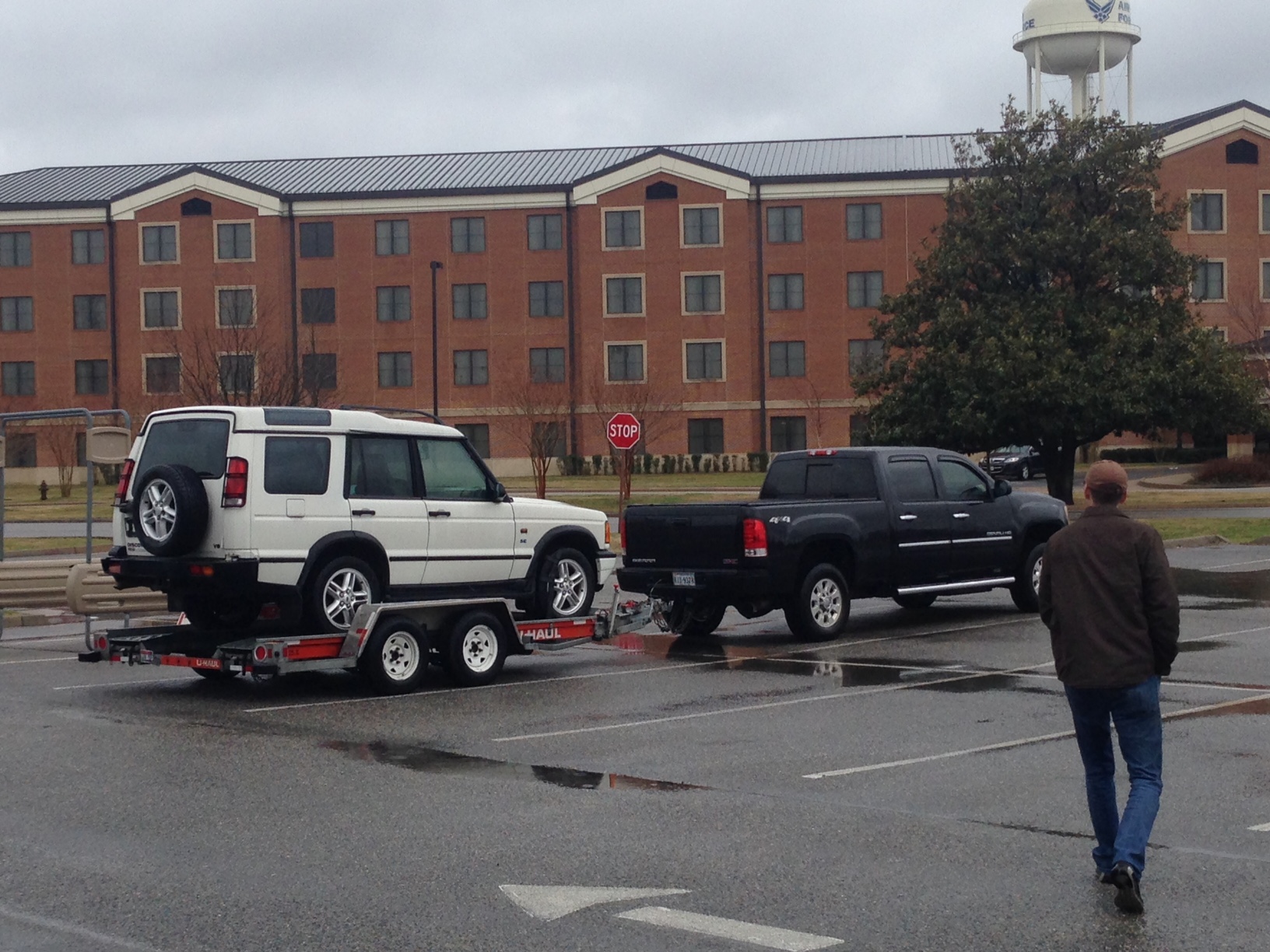

Just wanted to say hello and introduce myself. I am new to Land Rover but have been wrenching on cars for 15 years so they don't scare me. I picked this up from a buddy who left it sitting for 2 years after he was unable to fix a coolant leak. I figure its worst case head gaskets and best case a hose etc. For 200 bucks I couldn't pass it up and I was able to drive it on the trailer. I'm gonna find a fix the coolant leak and fix the leaking sunroofs and whatever else it need. Its a Florida disco so no rust and I'm happy about that. We'll she where it takes me but I'm excited to learn something new.

WELCOME to The Nut House! WOW that rig looks very clean from 40 feet, and for $200 you would have to be crazy not to buy it. Good Luck!

Nice score. For $200 you may have won the best deal of the year award. Keep us posted.

Nice steal. Even if it's the head gaskets...you will still be way ahead of the game. Paid 500 for my 01, so you got me beat...lol. Plus, mine needed a trans, y-pipe and front drive shaft (750.00 worth of repairs) right of the bat.
Looks to be a 99/02 model. Might have CDL transfer case, which is a plus for off-roading ( once you find linkage assembly, it won't be hooked up from the factory).
