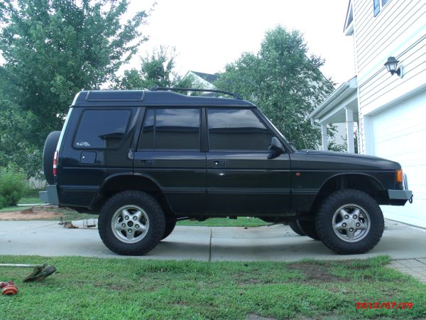

Hi everyone! My name is Dan and I recently bought my first car. A 1996 Disco with 2 inch lift, and full arb bumpers. I got it for $1900 from a family friend. My dad urged me to kid it because he loves rovers, he has a restored series II a and a disco 2. Well mine has been giving me some problems it has 235,000 miles but only 78,000 on the motor and 100,000 on the tranny. I have noticed it drips a little bit of oil (5 or 6 drops) everytime I park it and the lifters have started tapping, if i run it for 30 mins it grows a little louder. I was told it was from an exhasut leak but I have no clue. What causes this tapping? How can it be repaired? My mechanic says its normal for older discos and that it will still run fine but I have no clue. Any help would be great!
