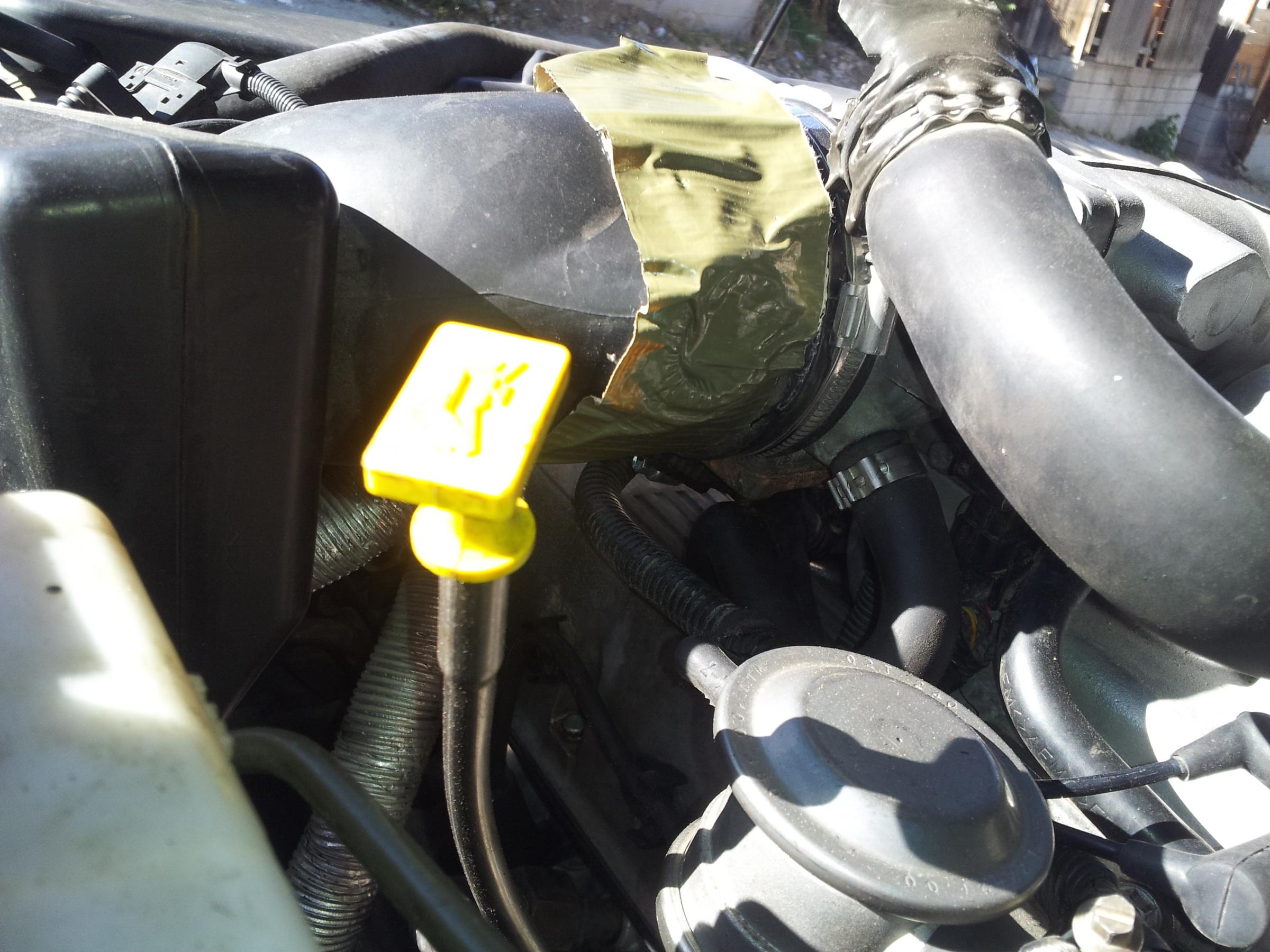

I recently purchased a dark blue 2003 SE7 with 138k miles and perfect tan interior. $1,500 Denver, CO. VIN # falls into the oil pump recall period. Unknown disposition. Starts just fine but then loses rpms and stalls*. When given fuel to RPMs over 1,500 it starts to knock, sounds like a rod bearing to me. Another "rover" mechanic said it was the cam bearings?. The heads are rebuilt, intake and gaskets replaced recently. other new parts here and there.

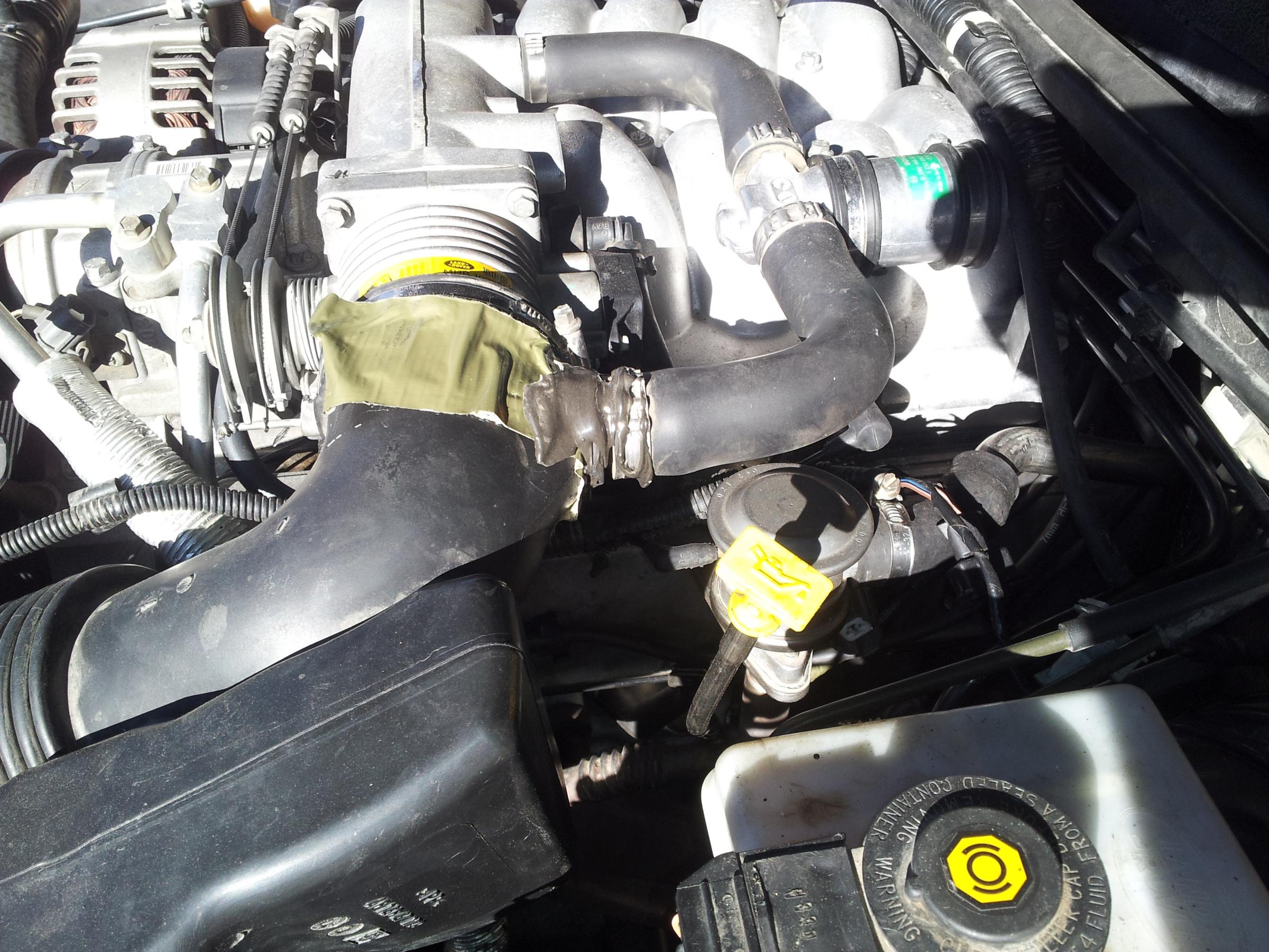

* in picture someone taped off the IACV idle air, is this some kind of British trick? Still has a loud knocking noise.

The IAC setup is what a hack does when the nipple snaps off. Find yourself a new intake tube or get creative with your plastic welder. By the way, that's why it is stalling after it starts. Regarding the knock, check to make sure you have oil pressure but if it sounds that nasty you will need to tear into it anyway. You can check the main and rod bearings by pulling the sump to see if that's where the problem is.
