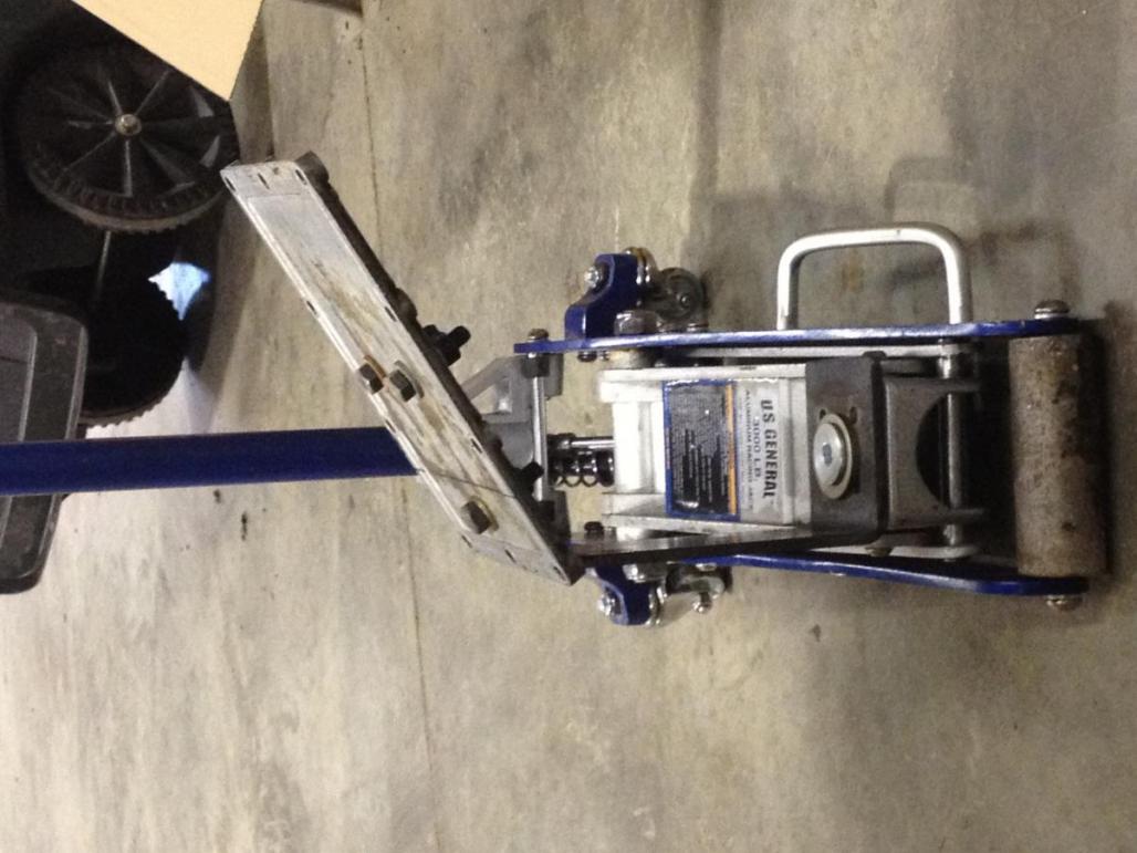

Odds are in your favor that it will just be a plain used case and in good order. Or just nab a cover plate and make a set up to manipulate yours.
