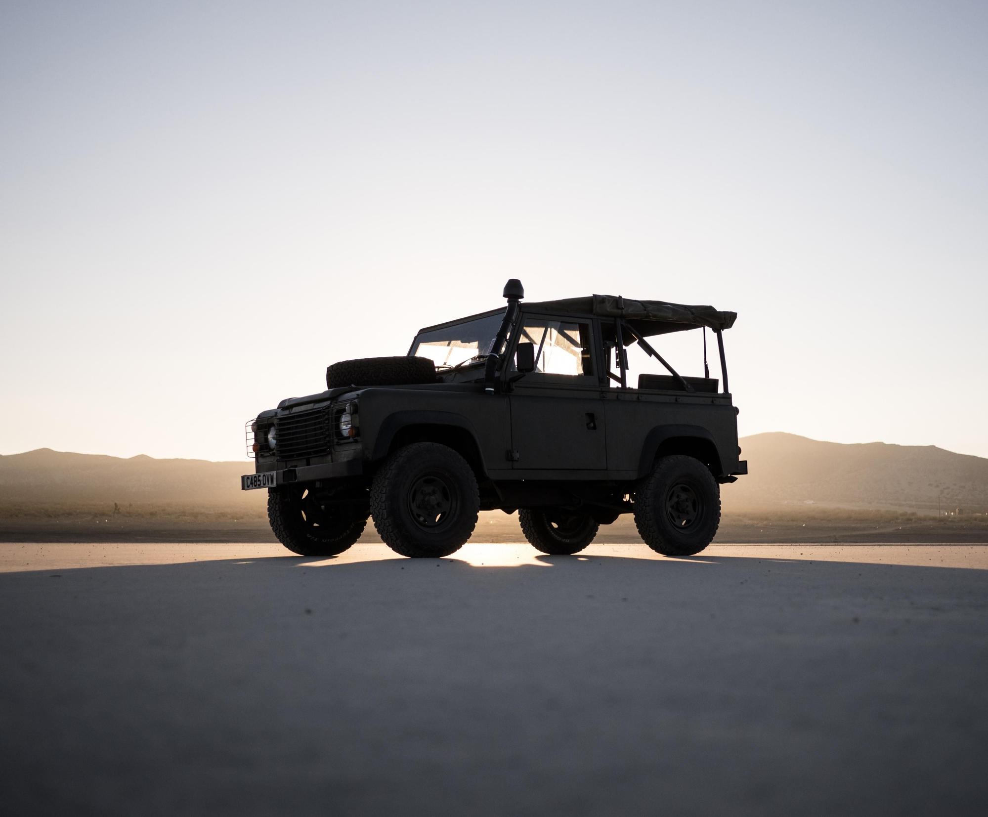

Alright - so I own an interesting Defender 90 - it's part Defender and part Discovery 1.
Pics below.
It's mildly famous because it was the actual Defender in the iPhone 12 commercial - some pics below - and video
View this post on Instagram
It's a RHD 1984 Defender body and Defender Axles, Gas tank, but the Engine is 1996 Disco 1 (as is the Evap system, Electrical, Dash, Transmission and pretty much all innards - up to and including the 10AS and the GEMS)
