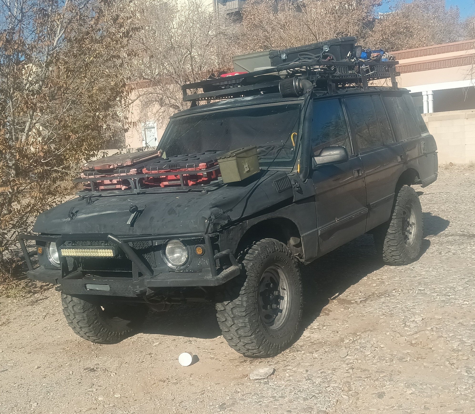

Default took my grinder to my classic...
and did a camel cut. Was time for new tires as my old 235/85/16 KO2's were about bald and went to some 285/75/16 Milestar Patagonia MT-2's. So why from tires that measured out at 30.5"x9. 5" to tires that measure out at 34"x11.5". Did the cut before the tires arrived and I think I nailed it pretty good. Took 3.5" from the front arches and 2.5" from the rear doors and arches. How does it look? I'm running OME Defender 110 HD rear coils in three back with larger upper coil seats welded on .5" lower than stock and OME RRC HD rear coils in the front which gave me 2" lift and is about perfect fit the tire size. Pics are before I reversed the centers of the steel rims.
