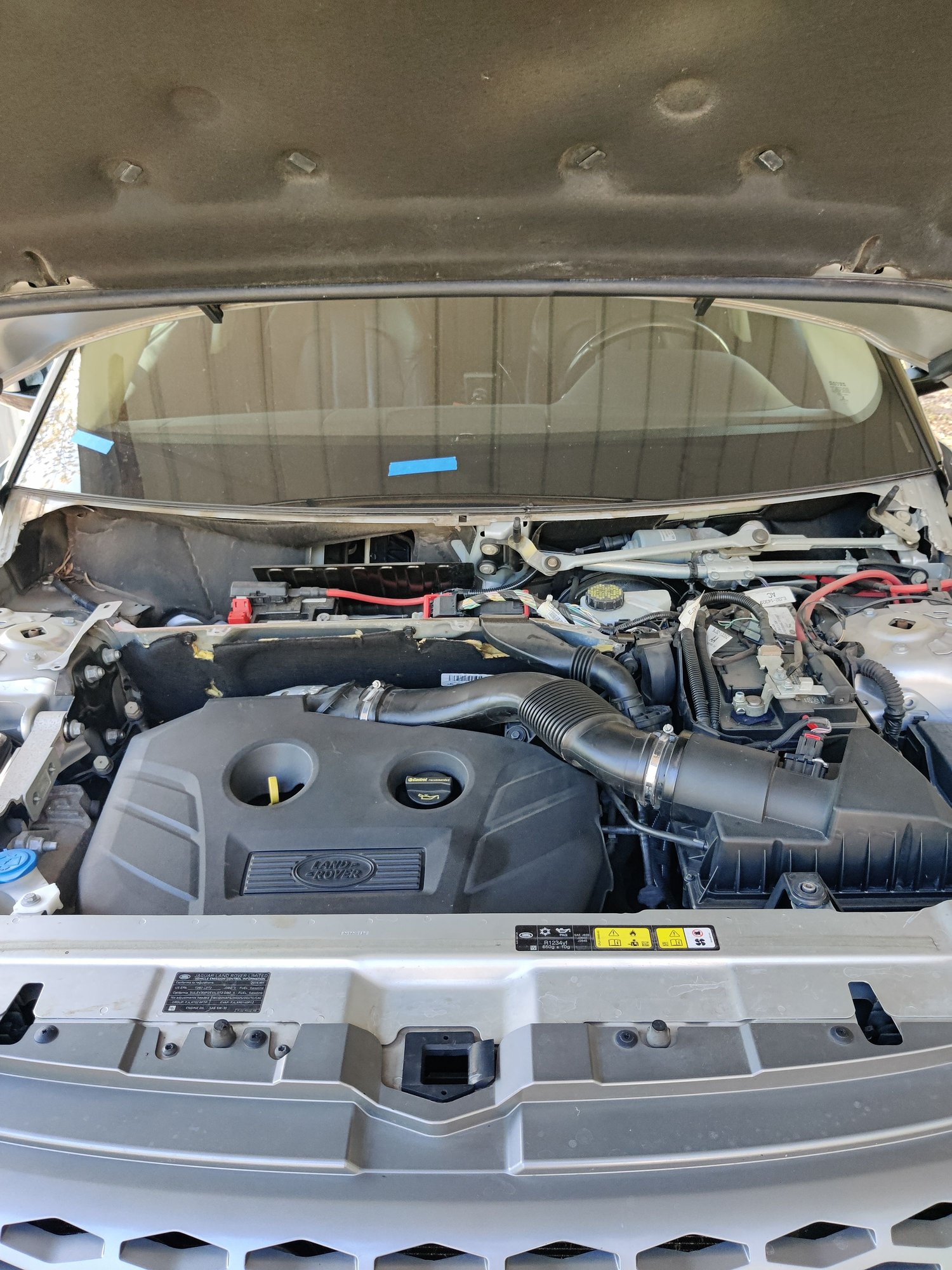

Start

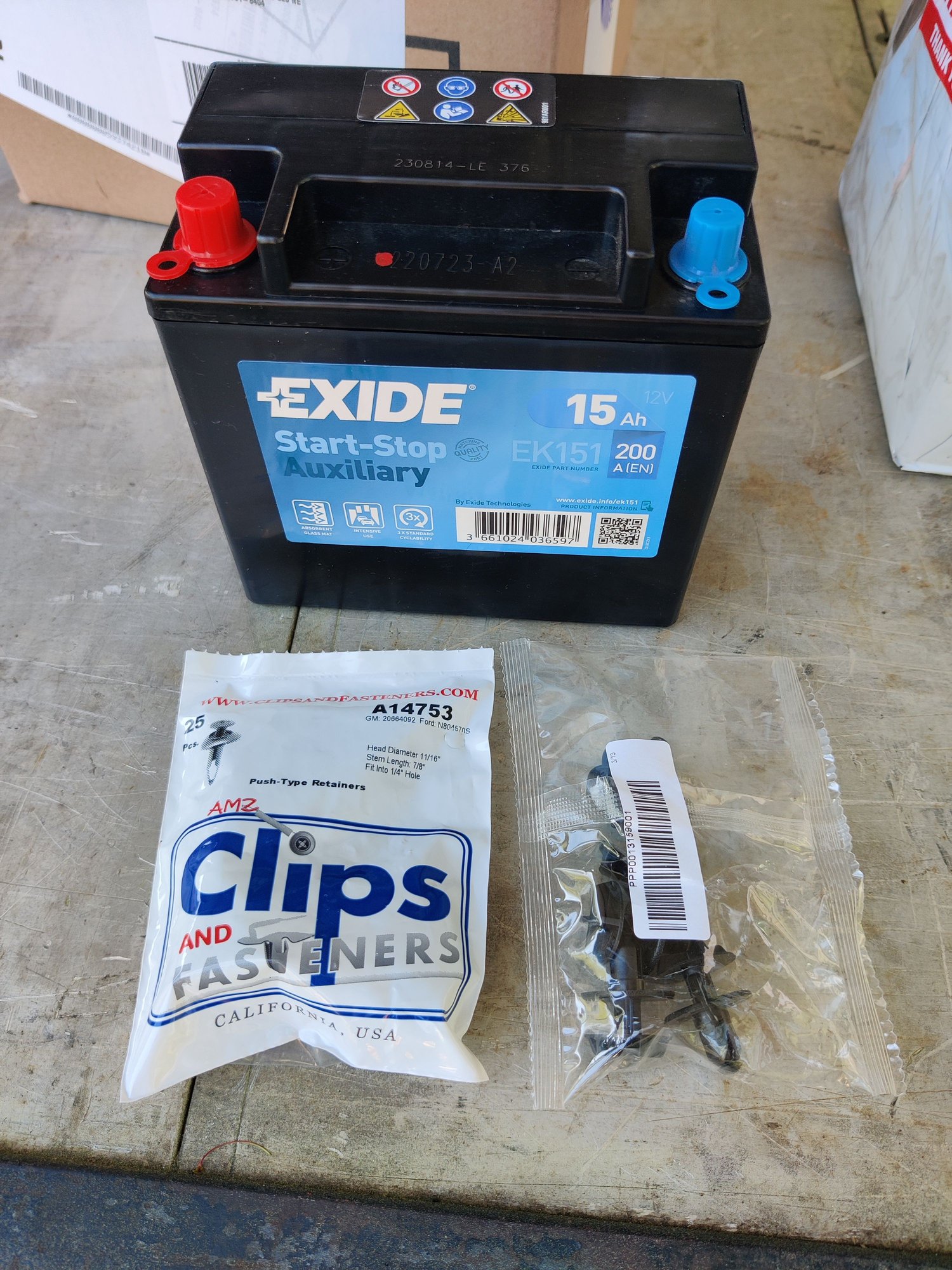

New battery and new clips.

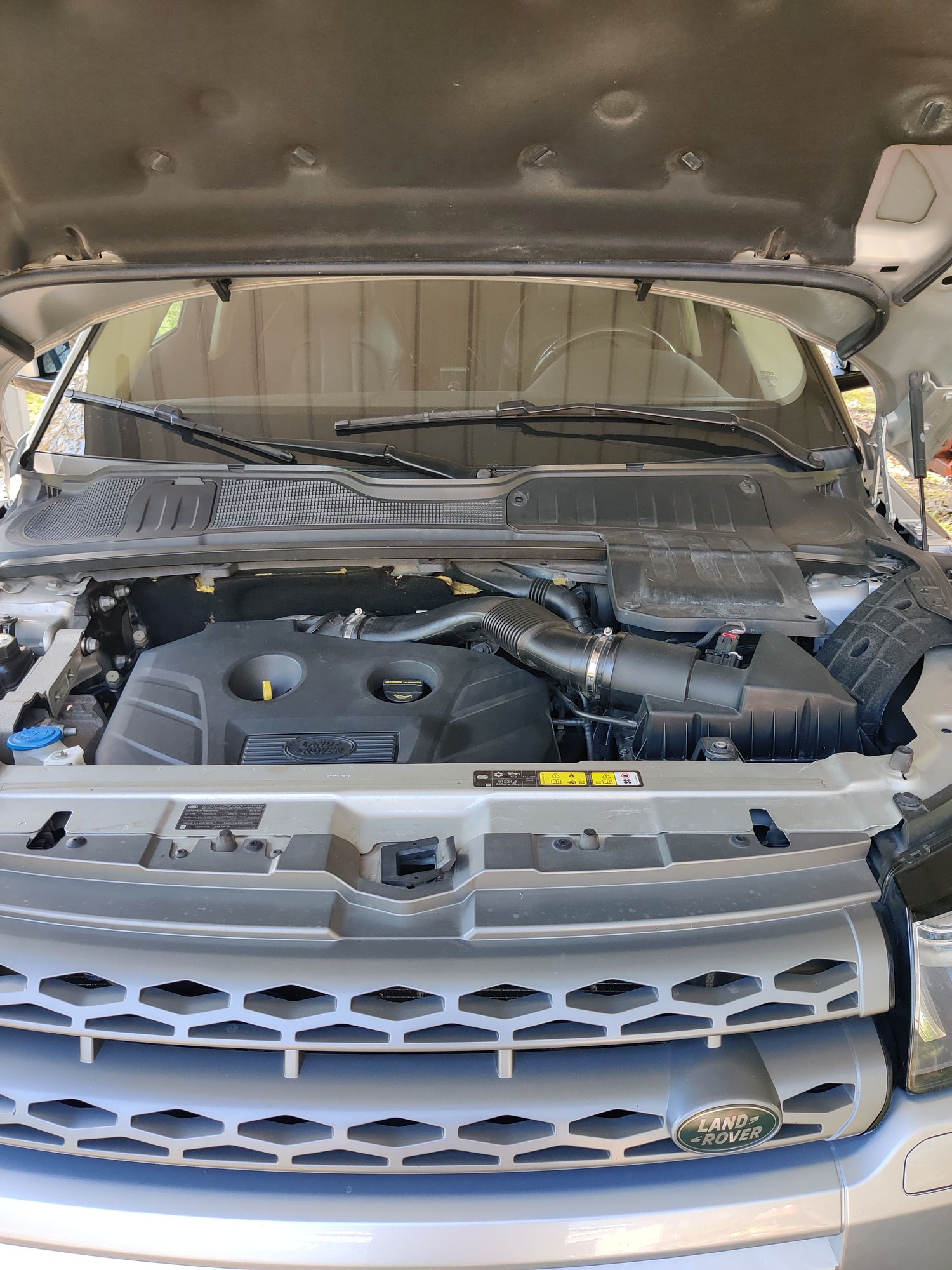

Wipers, covers removed.
Wipers, covers, air intake, cross bar.
everything removed

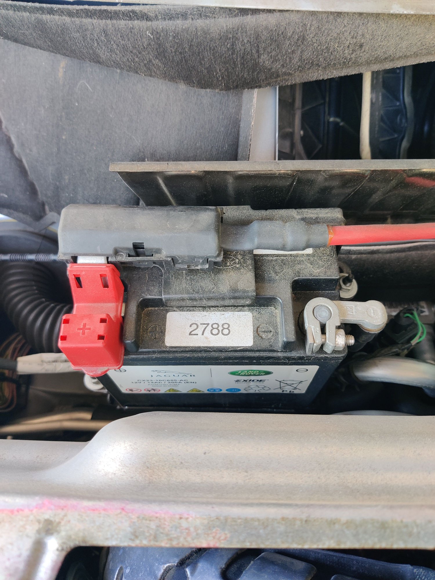

old battery
old battery 2

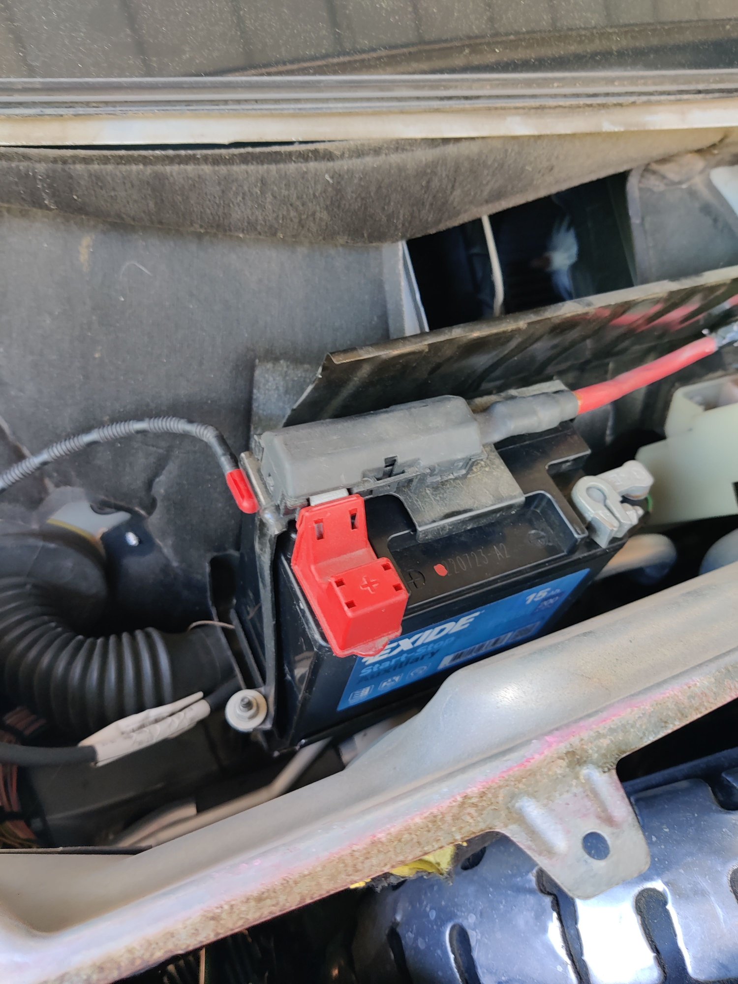

new battery, plus bracket secured
all installed, don't forget the vent tube.
pretty easy job.
