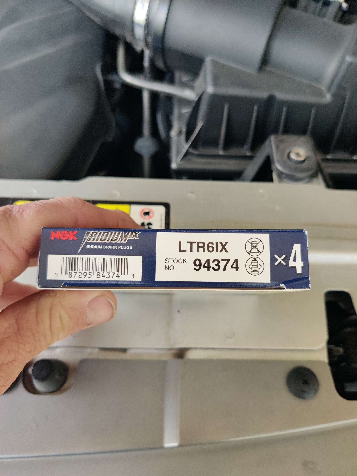

2015 2.0L spark plug change today.
2.0L Ford Ecoboost.
Replacement Plugs.

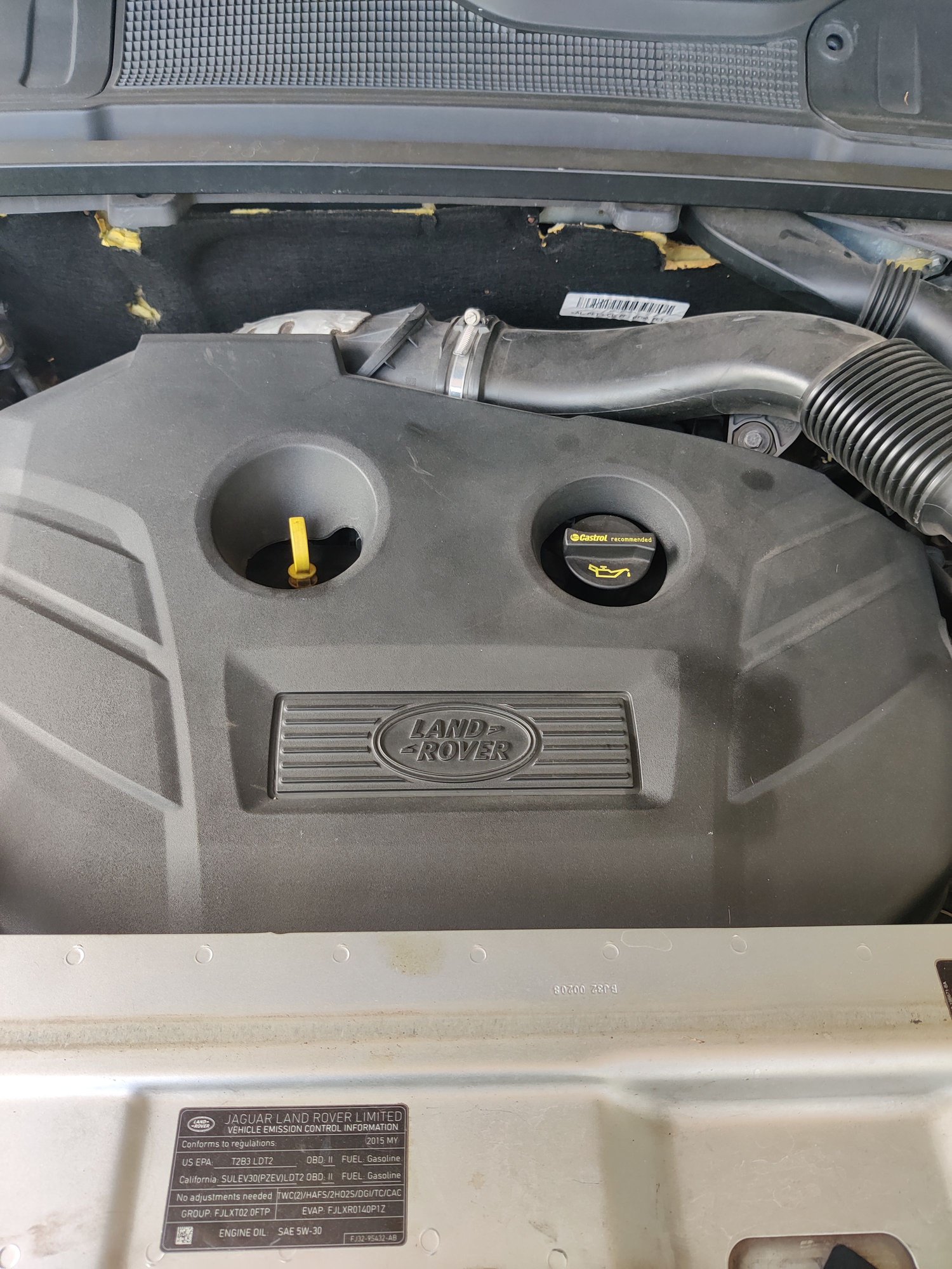

Cover removed.

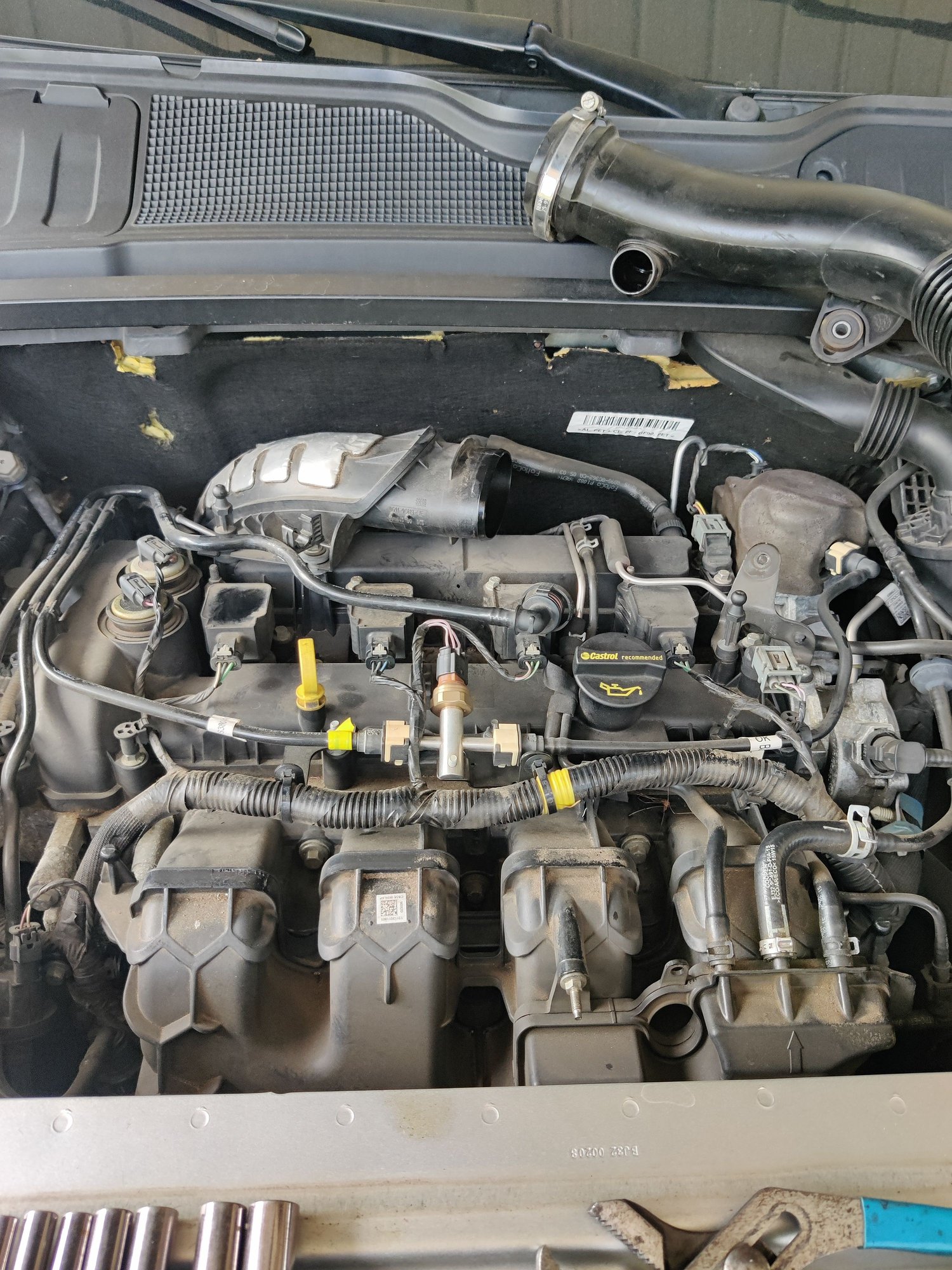

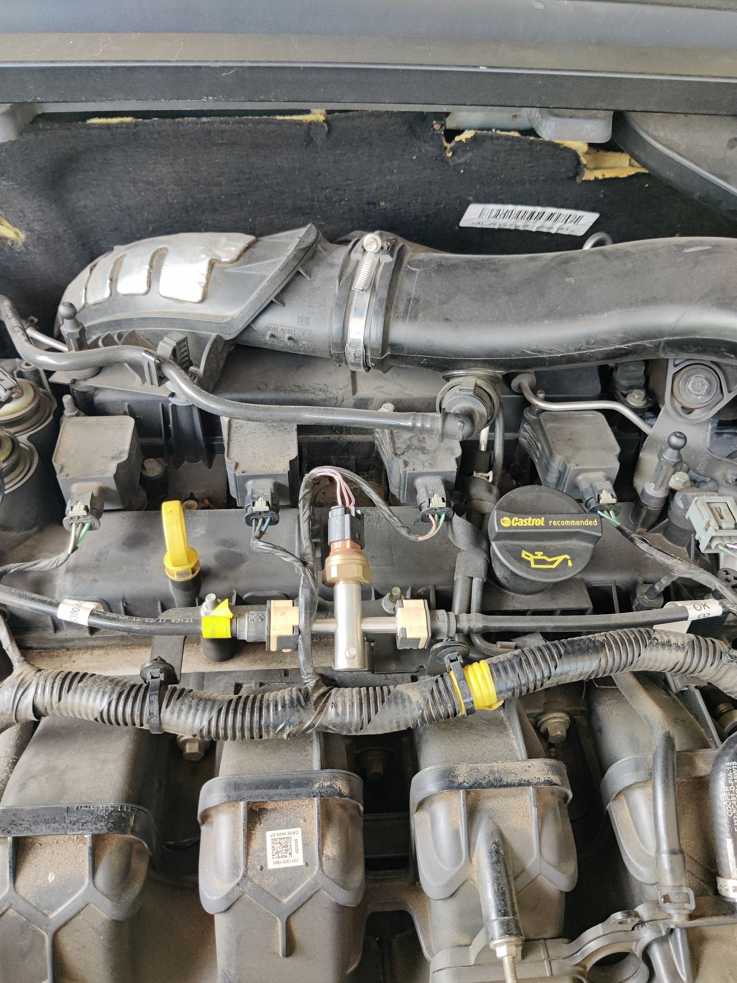

Coil pack, pull gray lock back, push down to release.
Remove Air intake duct to easily access all 4 8mm coil pack screws.
all coil packs removed
