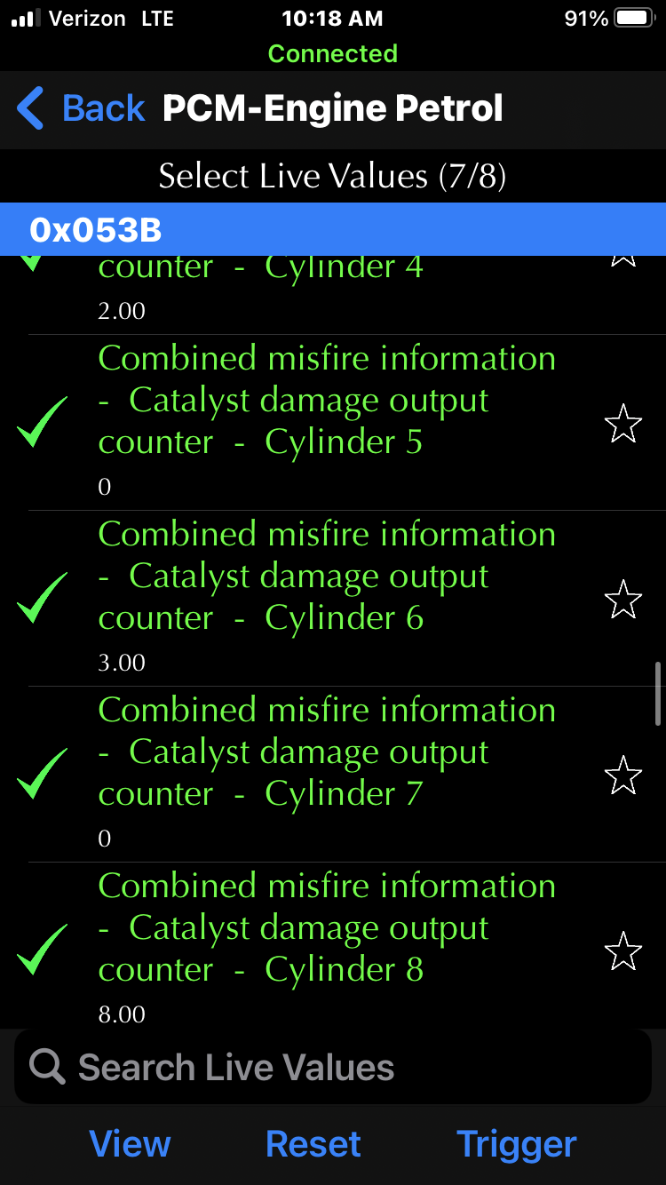

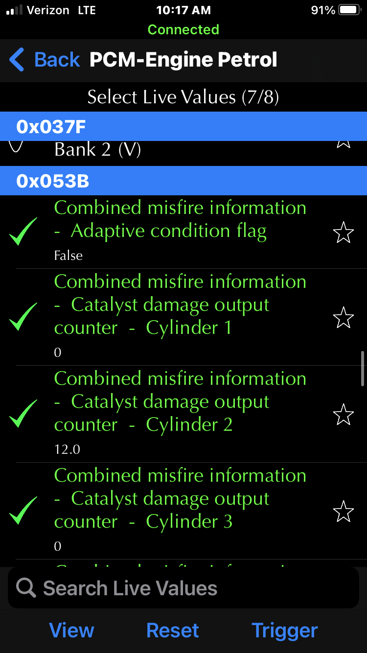

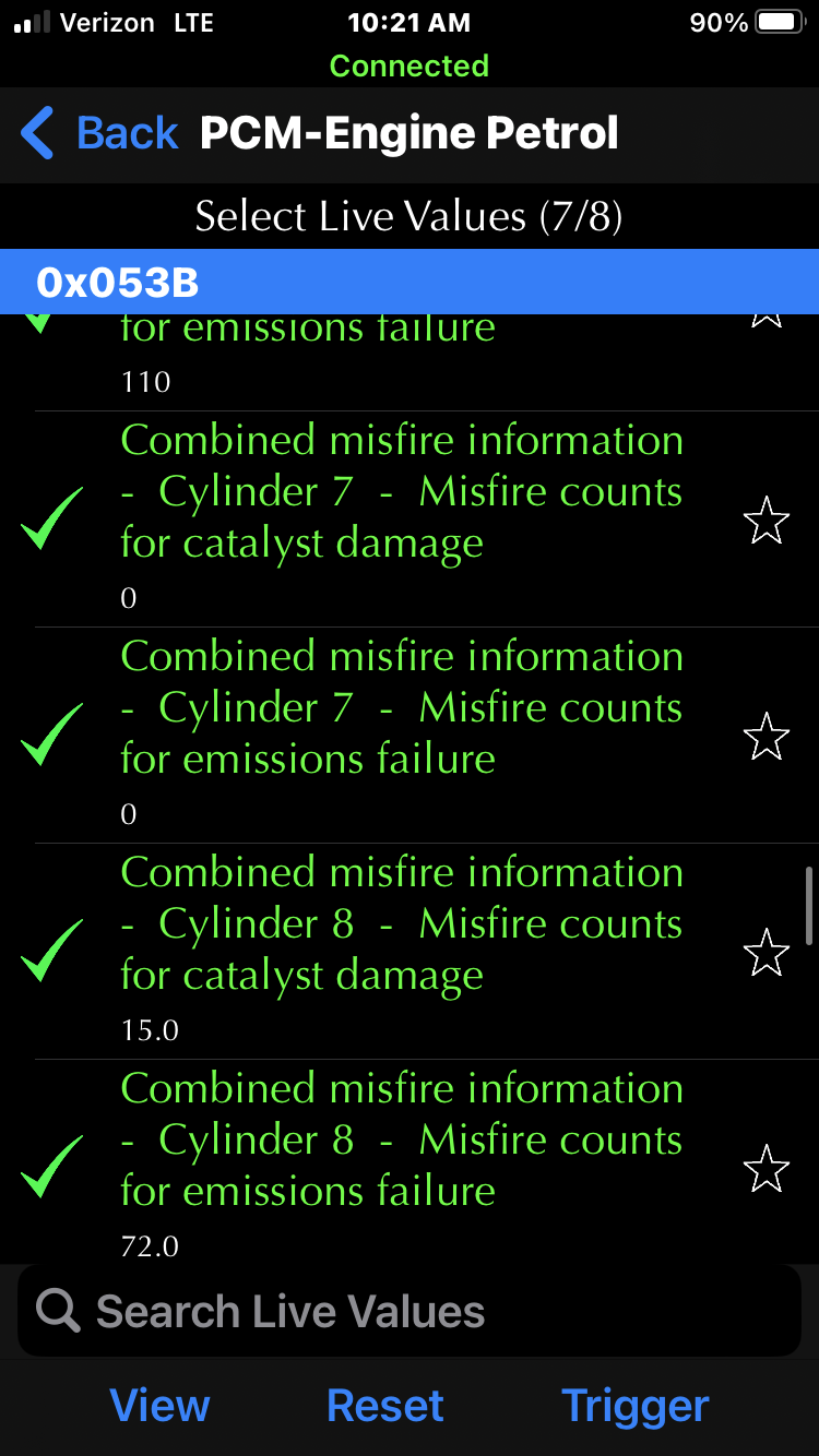

I have since realized I can look at the live values and see the misfire counts on the cylinders. I am unsure however how the restricted performance works and if it is creating the misfire to limit the engine to 4 cylinders. Primarily I see misfire counts on Cylinder 2.
I see two categories? in the IID GAP tool: Misfires counts for catalyst damage output, and misfire counts for emissions failure. I have a new Bosh Coil that I replaced with a new spark plug on Cylinder 2 but no improvement.

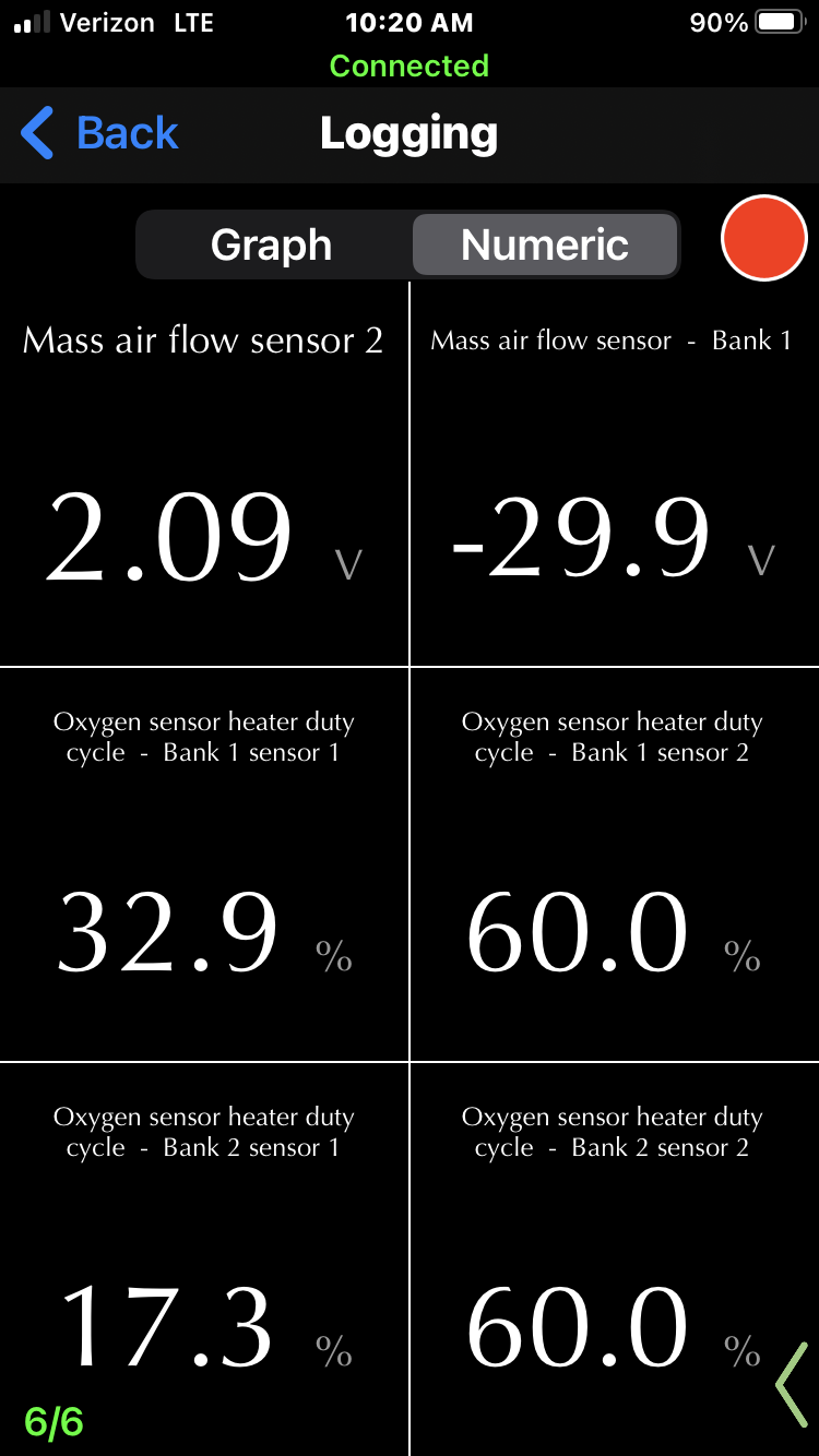

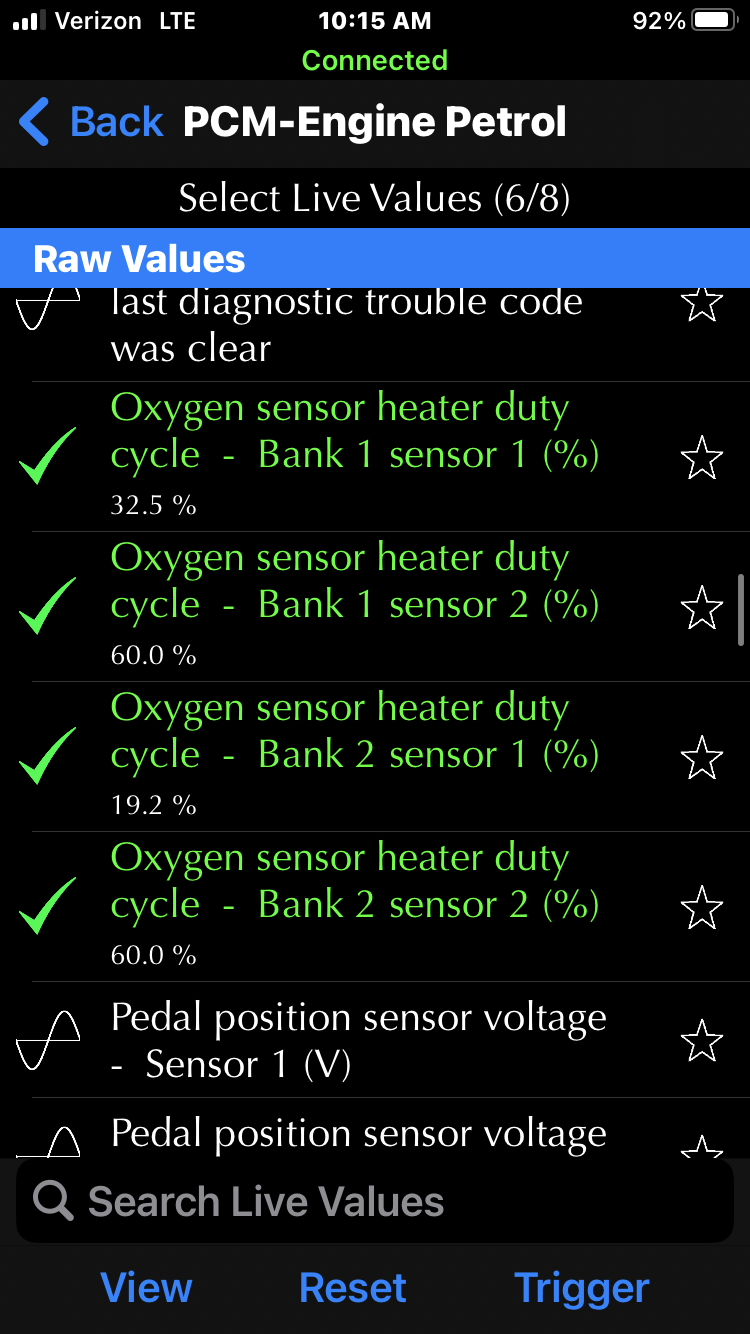

I have seen information to suggest there may be an injector issue causing the misfire. Are there Live values I can Look at on the Gap IID tool to determine the fuel information. I see a difference in the spray pulse widths between engine banks. .00198 and .00155 This is while driving in restricted performance mode at 2,000rpm. Also looking at Fuel rail pressure on Bank 2
Hoping for some information on reading the live values and suggestions of what reading to focus on to determine next step. new injectors, fuel pump?
