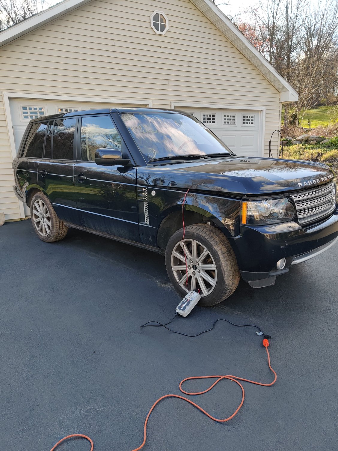

Hi guys,
Recently purchased "mechanical" issue 2012 RR SC with 70k on the clock. Car fax clean other than small fender bender 2 years ago.
I got the car it won't start. Replaced batter checked all ecus with IId tool. No faults besides instrument cluster.
Car has a slight click when trying to crank but doesn't physically crank but I hear the starter relay and whine slightly.
Changed the oil and a gallon of gas came out. Changed oil still won't crank.
​​​​​ Any advice would be great as I'm out of ideas. Even with a stick injector it should still crack
hit the starter with a hammer while cranking still nothing
Let me know what u guys think
Thanks
Phil
