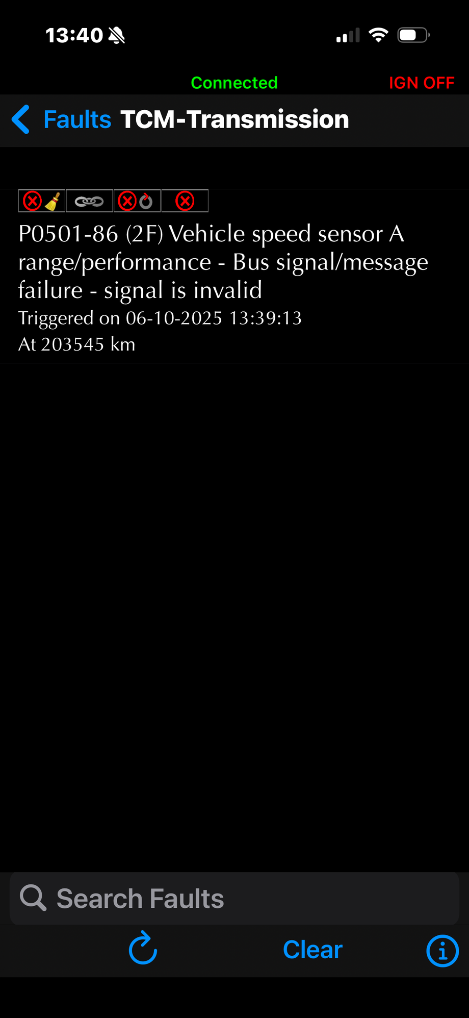

left rear code for an ABS wheel speed sensor. Replaced the sensor with genuine Bosch part cleared the codes but now this pops up. P0501-86 (2F). Vehicle speed sensor A range performance. Bus Signal message failure. Im disconnecting the neg battery terminal and hoping that helps. Using GAP 2 tool. The other codes are cleared.

Randomly. Just driving along and Christmas tree lights and lowered itself.. Had this happen on my LR3 with the ABS wheel speed sensor and the new sensor cleared all the codes. This one is deeper than what i can do with the Gap Tool. It may be a sticking caliper, I don’t know.
