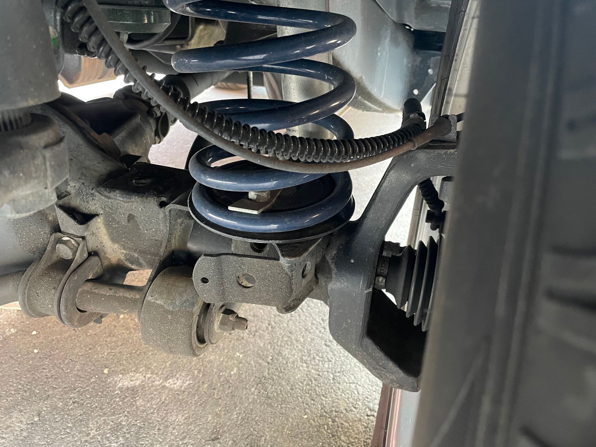

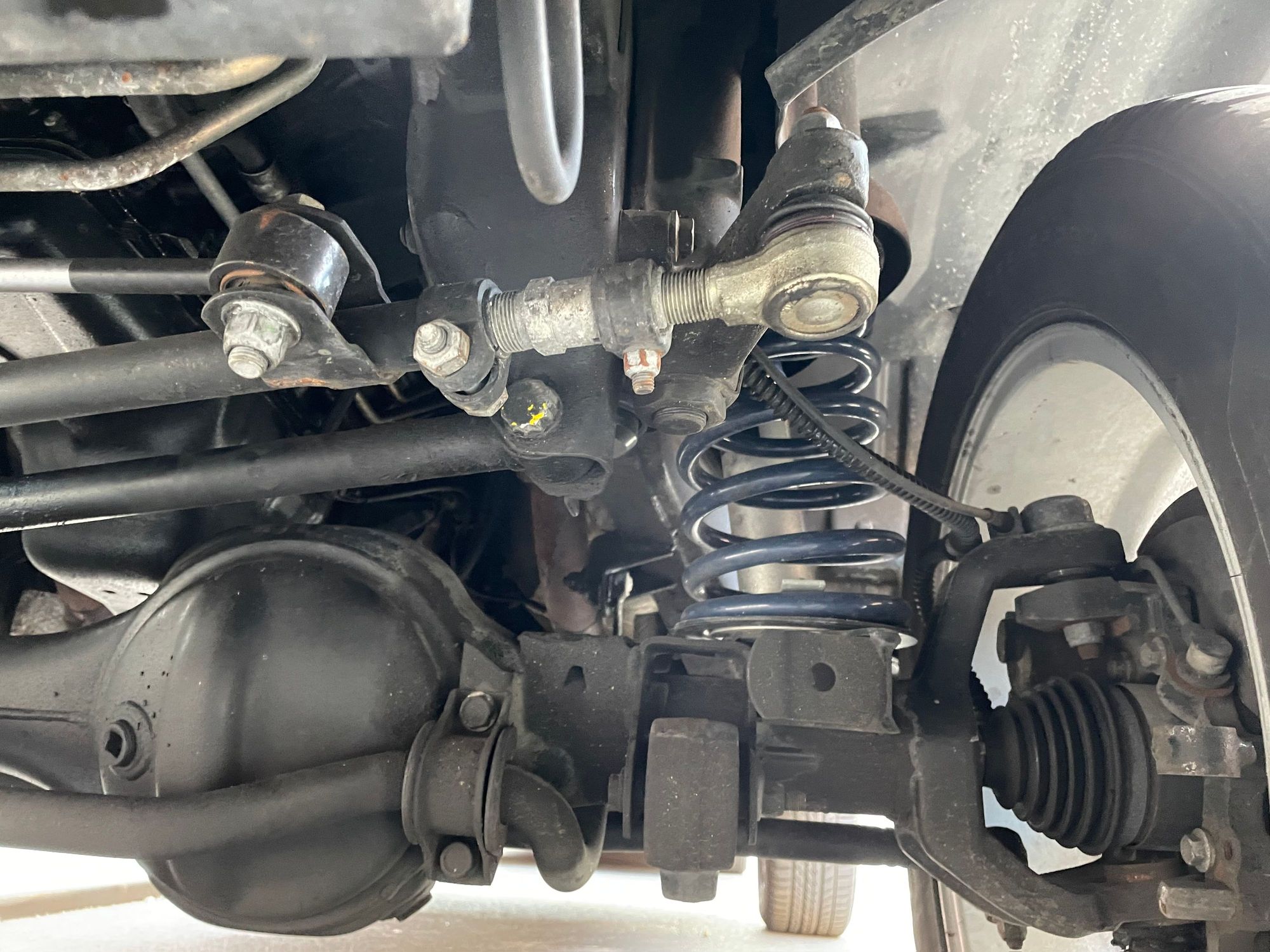

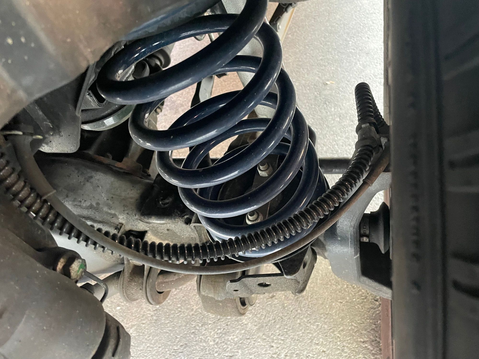

so i see a lot of information and how to's for converting the p38 air suspension to coil but not much on reverting it back to air suspension from coils. i watched a ton of videos on how to remove coil suspension on typical vehicles, some people use strut spring compressors and others removed the shocks first before removing the coils. wondering what people who have experience with this on the p38 would suggest as far as the procedure goes.
the car has only 78,000 miles on the odometer so the coil conversion kit seems pretty close to new whch means that i'll probably and most likely be keeping the terafirma pro sports unless someone can convince me otherwise. i hear mix reviews where people say to get the boge like shocks and others where people say just go terafirma. i would preferably like to to not spend money on new shocks.

I haven’t removed coils on a P38, but you will want to disconnect one end of each shock absorber so that the axle can move farther from the frame. If you’re lucky the spring might then come out without a spring compressor, but you’ll likely need to compress them a bit. If you search the Disco 1 or 2 sections in this forum, there are a number of threads on installing lifts, which explain how to remove and install coils.

i also noticed that the kit used was one sold by atlantic british:
https://www.roverparts.com/suspensio...ts/9520LBHDTF/
on their website they have a downloadable pdf on how to install this kit. i just downloaded the pdf and am going to follow it in reverse to remove the kit. wish me luck. really looking foward to bringing the airbags back. was looking at performance upgrades (torando chip, bosch gen 3 injectors, act carbon fiber trumpets) and figured i should probably bring back the air suspension prior to going ape sh*t on expensive upgrades. im sure that installing airbags will probably improve fuel efficiency which is always a a plus. ride height as is pretty tall and the front is higher then the rear which makes for terrible aerodynamics.
does anyone know if i have to adjust anything on sway bars or anything like that when i re-install the air bags?
also, i noticed these shocks have "2 inch spacers" do these need to be removed?
also something else i noticed is that bump stops were changed during the conversions. should i remove the update bump stops and install OEM ones or am i okay using atlantic british bump stops they provide in the kit.
