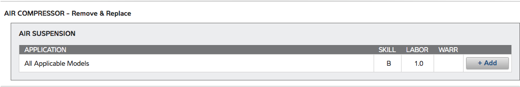

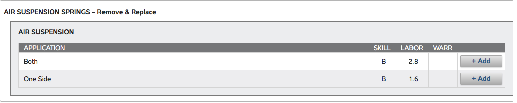

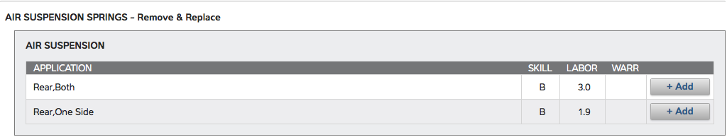

Old Sep 9, 2017 | 08:29 PM
abran's Avatar
Posts: 6,919
Likes: 794
From: Huntington Beach CA
Old Sep 9, 2017 | 09:00 PM
Mads Jakob Poulsen's Avatar
5th Gear
Joined: Sep 2017
Posts: 5
Thanks abran, thats amount of labour hours?
