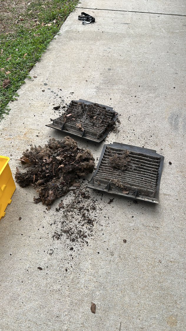

I started messing with the HVAC on the old girl as that one is very important
First stop was the Fuse box checked it all over and found the relays were not happy
Then I went to have a look at the cabin filters before I went any further as my googling said they are a common overlook on the maintenance
There was a lot inside with the mouse condo I demolished. Well it sort of paid off. I believe we have one working blower now
It might need more cleaning not 100% sure though😂

Crazy! Glad you got it working.
You’re probably aware, but that fuse/relay box has been the demise of many P38’s. A good practice is to disconnect clean and reconnect each fuse and relay, as well as displacing the box and doing the same with the plugs on the bottom. My windshield heater relay connectors looked a bit like your cooked relays. I use Nutrol Contact Cleaner, which is an electrical contact cleaner with a bit of lube added. I’m not sure if the lube really helps but it makes me feel better.
