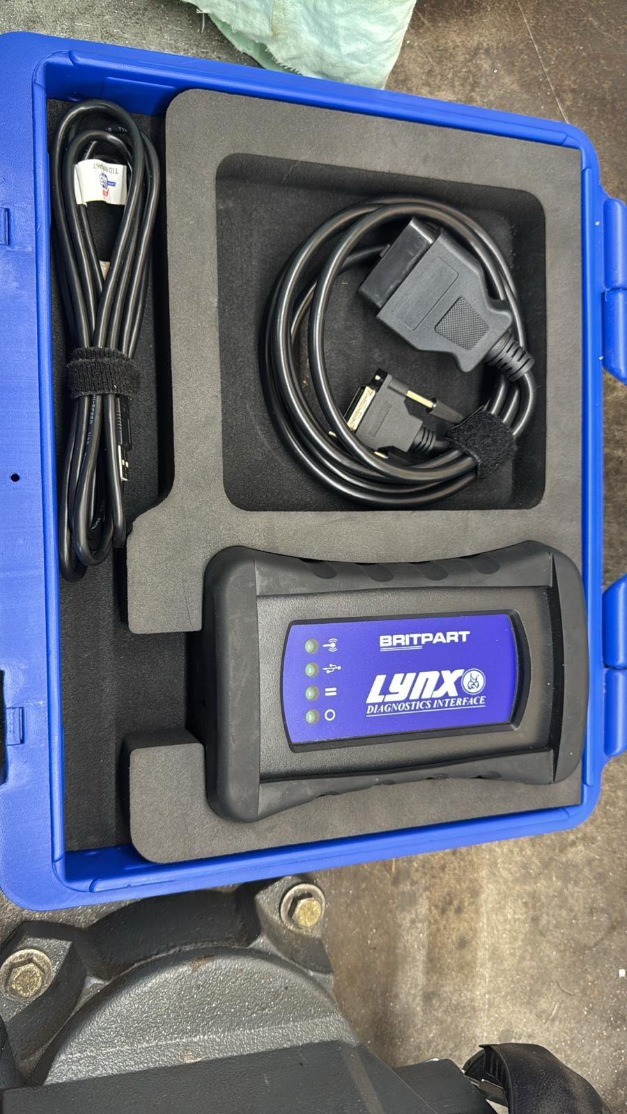

A good friend has a OG Lynx setup that he no longer has need for he is sending that along. So it looks like I will be needing to figure out if the old toughbook still powers up.
If it does power up and this can’t do the job I’ll roll the dice on RSW perhaps. I have sent multiple emails and have no response so far.
