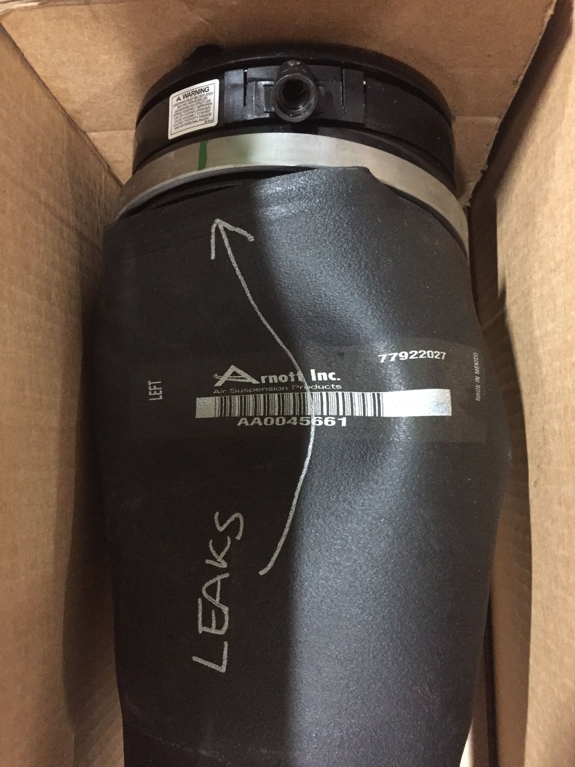

We loaded up 4 wheels and tires in the back and drove off and we got a system fault and then as we were stopped at a light realized back end lowered down. Front is at normal height but the back is slammed all the way down and won’t re level. Could this be a leak or compressor failure? I do here the compressor come on but the back doesn’t move I recently within the last 6 month replaced the rear struts

Could be as simple as a line popped off bad height sensor etc etc need more information

It very well could be as Army Rover stated and a line blew out. I have seen that when they are not pushed fully in. Also, most people won't spring for the factory Air Springs (don't blame them) and I have seen some Arnotts fail is a short time.. You'll just have to check it out.

We had an L322 Supercharged make it 24 hours....
Truth is, the failure rate of the Arnotts is pretty low, but when you do a high volume, you tend to see it more than once. Two things I noticed with Arnott is:
1) always get "new" if available. Remans cost less, but seem to have a higher return rate. 2) if you are going to have a blowout due to assembly issue, it usually shows up in the first few days. If you have some miles on them, you are probably good.
