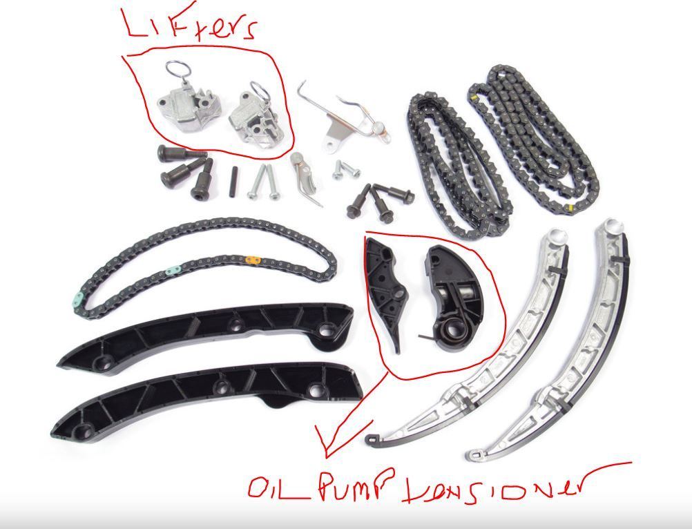

Update, TC tensioners not too bad but the tensioner lifters frozen, oil pump tensioner broke in half but stayed in place, just rotated the spring inside so more rattling. Waiting on the oil pump tensioner to put it all back together. Also doing the spark plug service while valve covers are off. An extra day on parts but the owner/master tech said my rover was in great shape. Now the wait...sorry for the crude printing in the pic, just thought any new owners might like to see this ****ery. The oil sending unit sits at the bottom of the block and normally you have to drop the engine to get to it. Torx bit, frozen, grinded a bit and got it out, flattening out the sides of the bolt so they can use a 13mm wrench on it, time and labor saver.

Metal shavings seem to be pretty common from what I’m hearing, they tested again and none, the magnet and oil filter must have worked 😎. Previous tech = grifter. From what my tech said the SC rattles much more, makes sense. Sadly no, I didn’t get a recording of the sound but after it warms up and rpm dropped you could hear the slap/tick of the chain, def a discernible sound, especially in a garage. Take a long flat blade screwdriver and press it to the drivers then pass side of the front of the block, if there’s slack slapping around you’ll hear it.
Can you find out of the oil pump tensioner was replaced or oil pump itself? That little black part sits at the bottom drivers side at the front of the engine and keeps tension for the oil pump, mine had cracked enough that the spring had rotated 180* then fell apart when pulled out. $50 part.

I believe the black tensioner is LR parts only, I know it comes in the full kit but the full kit wasn’t ordered, it was like $50 for the part thru my tech.
