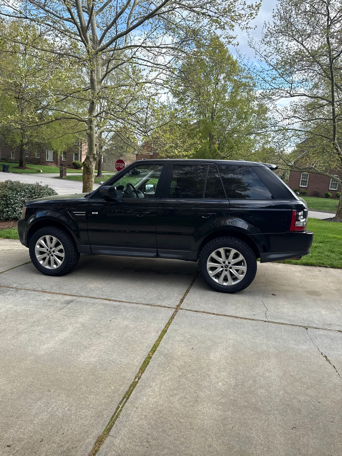

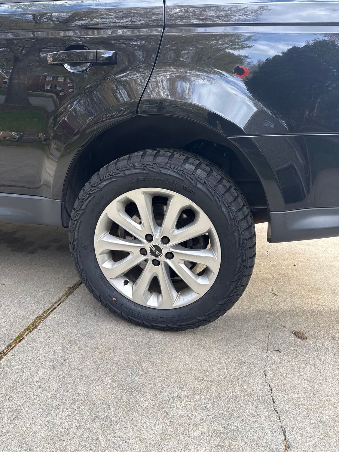

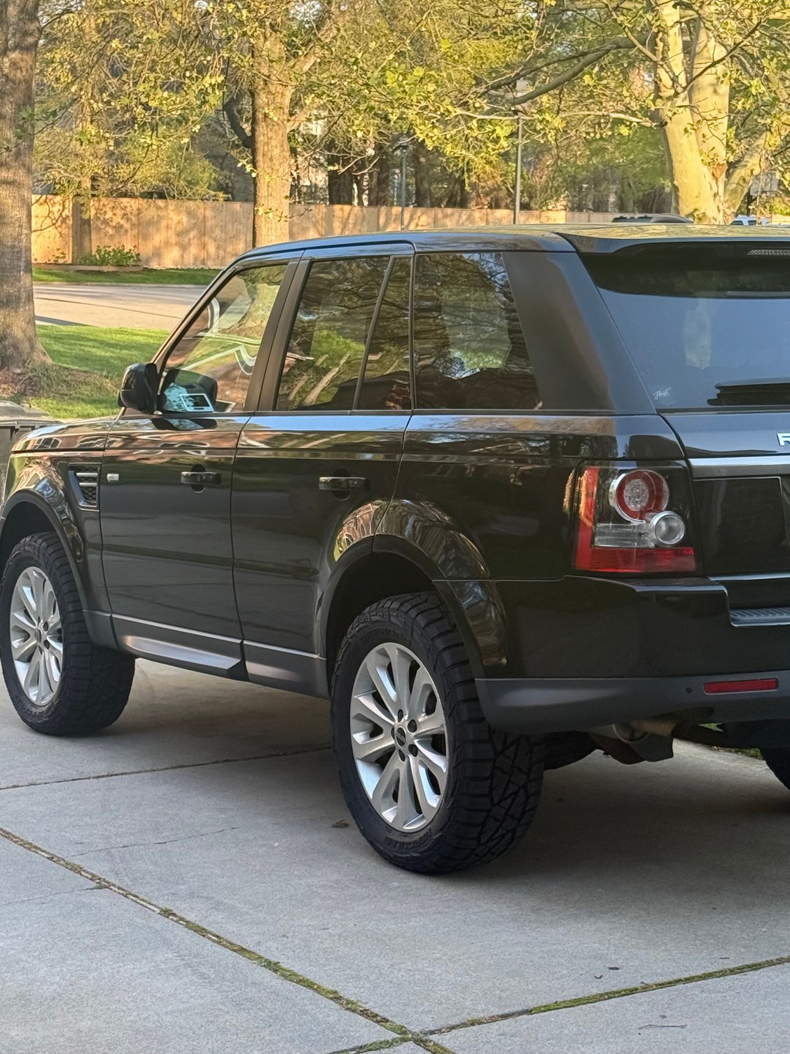

Get rid of air and do Atlantic British coil shocks the heavy duty ones. I just did it and got some new shoes
