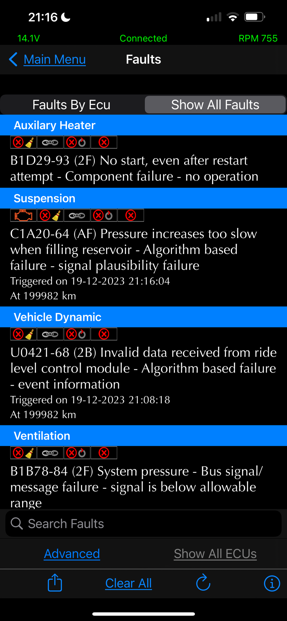

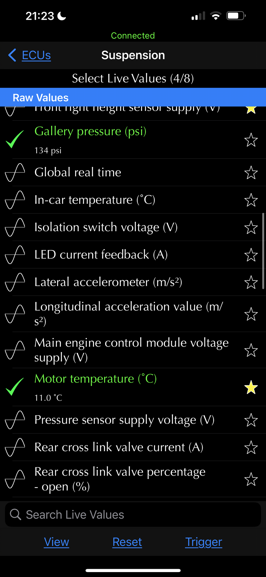

Hi guys, I am also being plagued by pretty much the same suspension issues everyone else has gone through. I haven't had time to do much of the standard checks, but one thing that has me
baffled, is the Compressor Motor temp constantly showing 11°C! With my Gap iid its showing that its running AMK firmware which is the correct version. I have seen other posts with people show what seemed like normal temps, up into the 75-100° area.
Anything/anywhere else i should look into, for that to
being showing incorrectly?
It never fluctuates!!!!
