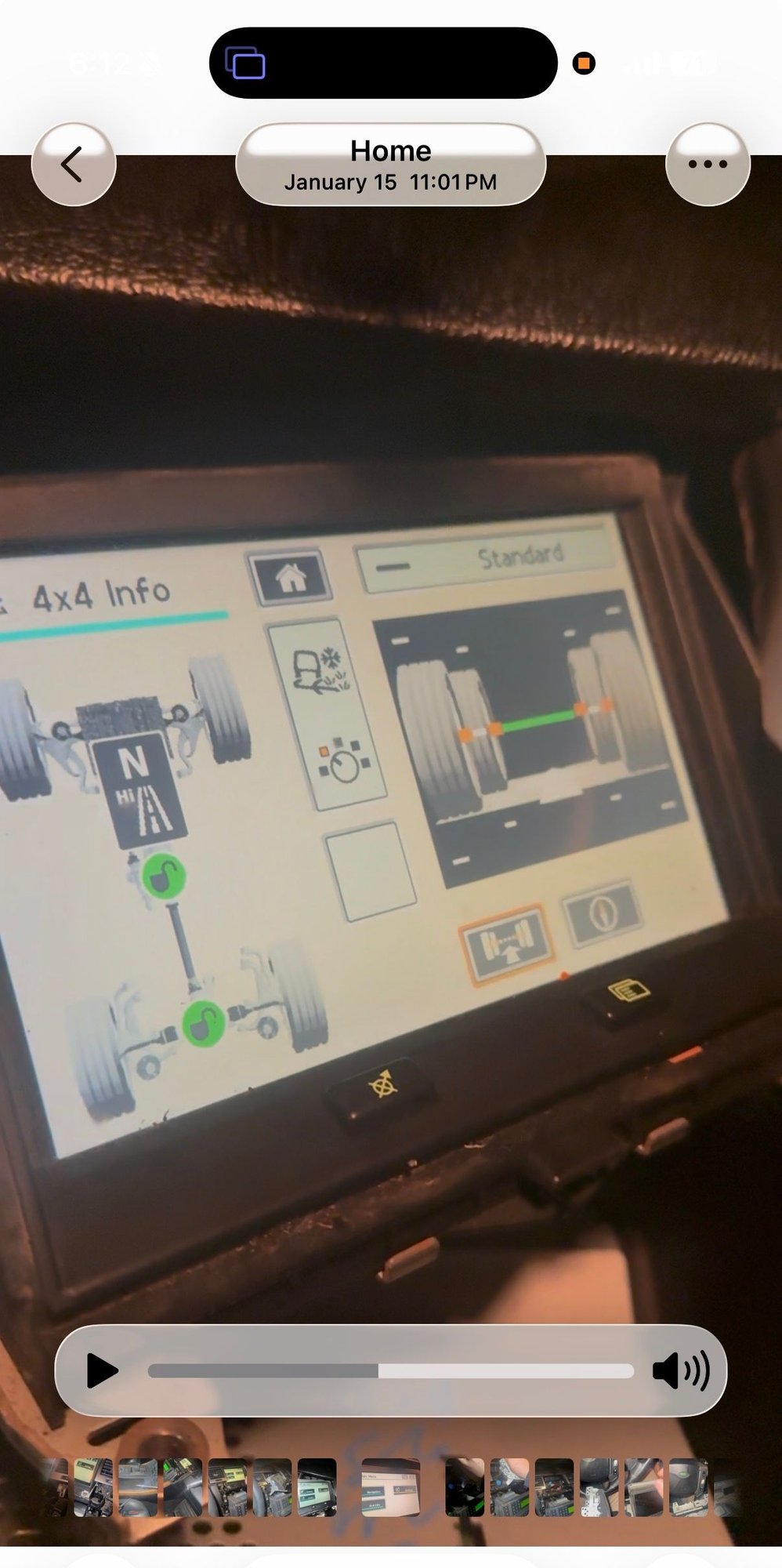

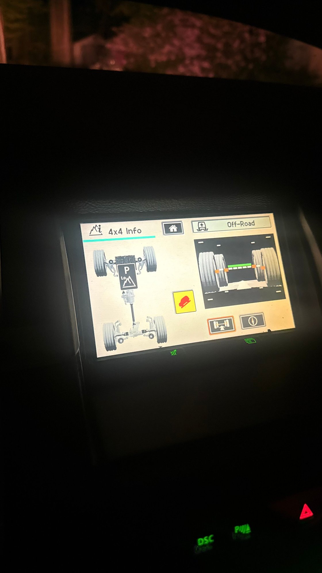

On my 06 RRS when I first got it it shows on the 4x4 screen that it has the Center diff lock and the rear diff lock. A few months later it stopped showing up for no reason. I went into a deep dive and SDD and my diag tool could not detect a module. The more research I did it looked like it never came with it but I remember it working at one point and even have a picture of it working. I’m genuinely confused now on how to check and see if A what’s wrong with the system and or B if the car gaslit me into thinking it had it or it was confused in software. Or C just put an air locker in and abandon the idea of using the 4X4 screen. I’ve also noticed the screen can no longer differentiate what mode the system is on. Any help is appreciated
This is the before when it worked
Vs now that it does not show up

I did try a hard reset multiple times. I did end up finding the issue to be a loose connector on the back of the navigation head unit. On the main harness itself, there are 3 wires separated in the whole harness that are the 4x4 Info wires. Colors Green Yellow and Black. On the harness I had the black wire became loose and i had to push it back into place and it did fix it.
