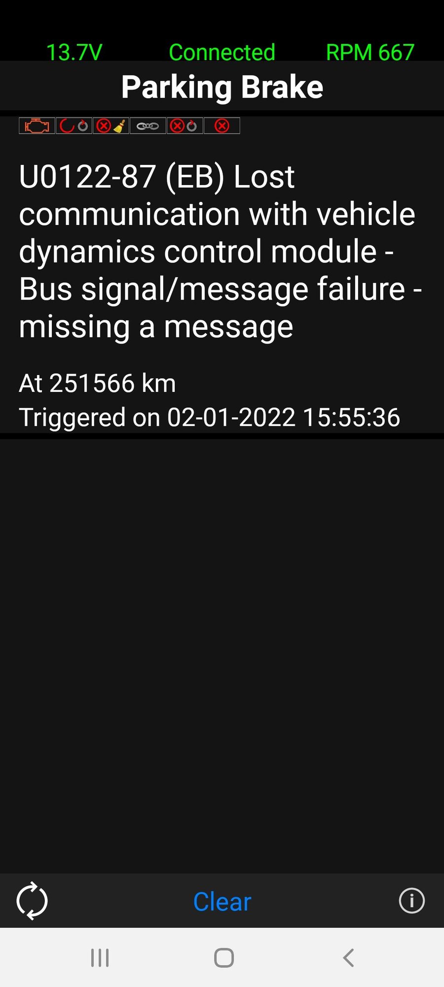

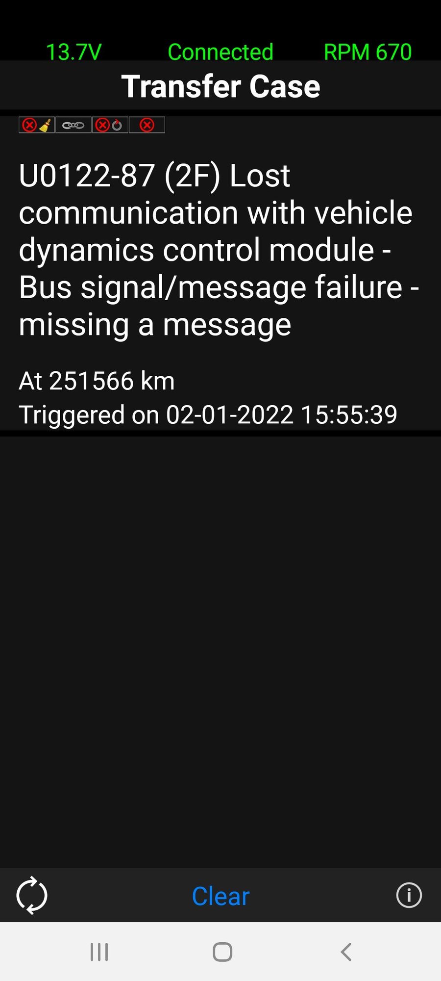

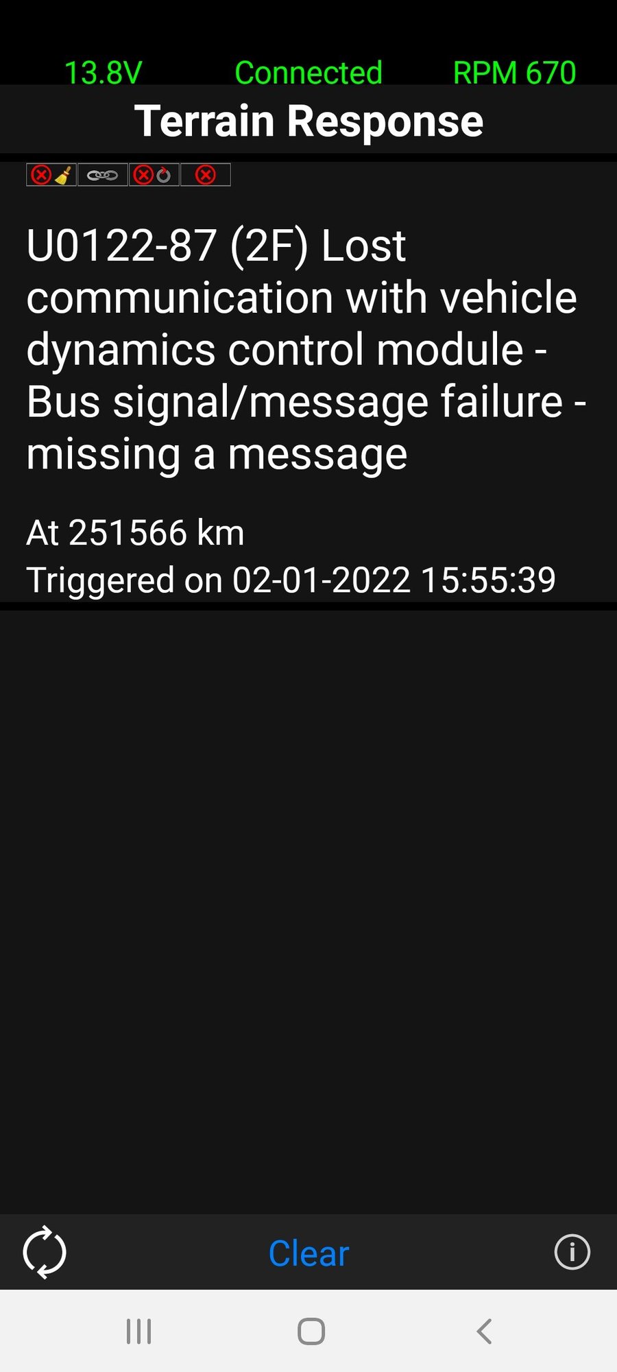

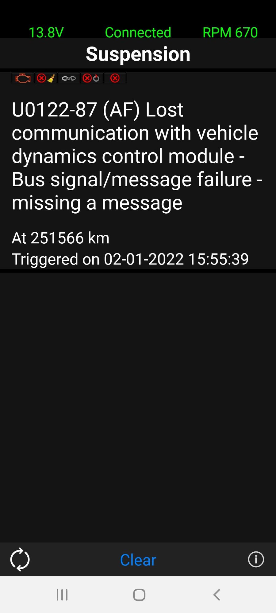

This would be the problem , I think , others are a cosequence of it .
Anyone out there please, I have just fitted a new inlet manifold and I get these faults after the rebuilt , I tried to erase on Gap but its not happening . I have checked all the plugs I had disconnected but nothing obvious there either. Sorry about the size of pics ,I don't know how to resize.

Some good news and some bad ! Fuse 37 cleared the faults in the pictures. Bad news is I still have the P000E-00(2F) CODE , does seem to be one CODE I cant help with on here.
Although the car is running a lot smoother.
