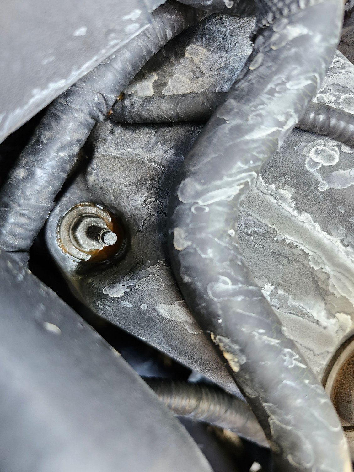

I found a new shop that I felt was more upfront and honest and provided me with more detail which made me feel comfortable. I recently brought the vehicle in for an oil change as the last one was done at around 151,000. Before taking the vehicle in for the oil change I checked my coolant level the day before. It was slightly lower than expected so I topped it up. At the same time I noticed a faded white looking 'splash' all over the engine bay, specifically on the right/middle side of vehicle, between engine plastic cover and coolant reservoir especially. Picture attached.
I made a mental note to investigate further but dropped the vehicle off for the oil change. The mechanic told me that I would need a new water pump after I went to pick up the car for an oil change. Im not sure if this one will be under warranty still or not. He did not specify what he saw or why I would need a new water pump, but based on the white splashes under the hood on the engine bay and what ive seen online related to similar images/forum posts it looks like water pump is a good guess.
This is going to be my 3rd water pump since getting the vehicle, which feels insane. However, based on posts I have seen there are some other components that could be contributing to the wear and tear of the water pump that may be worth replacing. By replacing these you may also replace the endless water pump failing issue seems to be the takeaway. I was wondering if anyone could shine some light on the parts below, also pictured. Are the parts mentioned and plan a good approach to my issue? Or, would you not sink anymore money into it assuming it will continue to give me problems. Any and all feedback greatly appreciated!!!

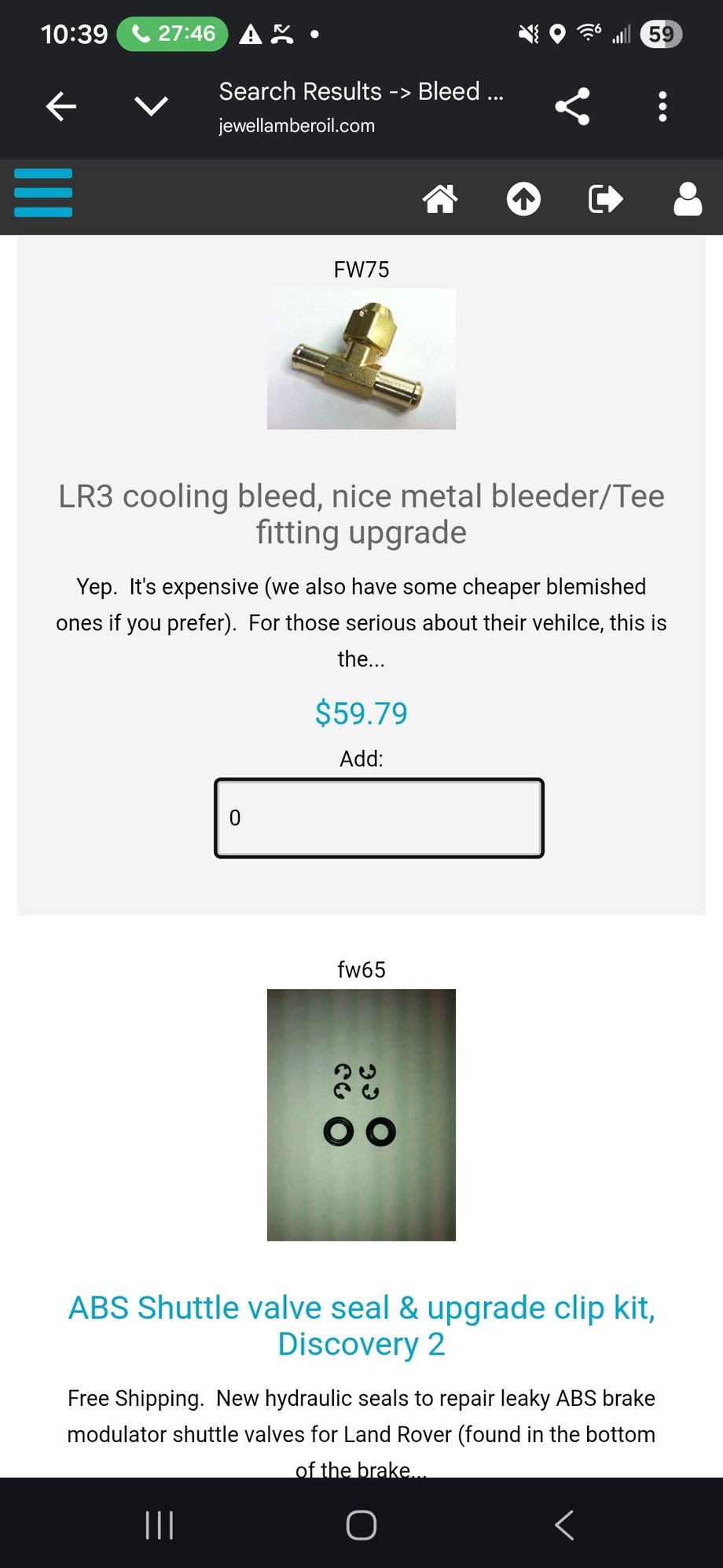

4. Replace bleeder t-valve Aftermarket (all metal replacement from falconworks - plastic OEM valve seems to cause problems for people and it is recommended to swap out.)
