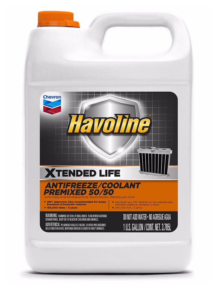

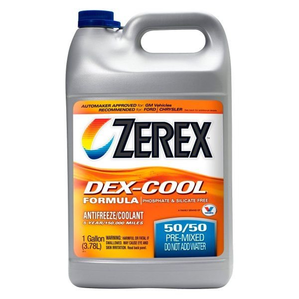

Thanks Dakota, much appreciated! I ordered the AC Delco from amazon and should get here tomorrow. My belts have recently been replaced, but do plan on replacing the bleeder-T as well. What coolant did you roll with upon refill? I have read either the original LR coolant or Valvoline Zerex Dex-Cool. Do you know if that’s accurate?

Just make sure its Dex-Cool. I did more reading about coolants than what I wanted when looking. All my other vehicles got Zerez G-05 and that was the plan for the Rover. But it really needs to be Dexcool - which is a generic standard for a coolant type. So you are right in going with Zerex Dexcool which is both inexpensive and easy to find. The other option is Halvoline Extended Life which is about as close to factory as you can get. For some reason, its not easy to find locally. Then again compared to others, Zerex is not either.
