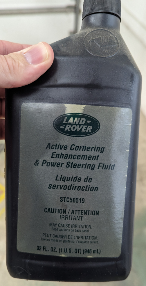

The ACE system takes a special fluid from Land Rover. Unfortunately I think it's like $50+ a quart. If it's low there's a leak in the system. The most common place for them to leak is from the rear sway bar "can" that does the work on the rear end. It's near the middle of the sway bar and about the size of a soda can. That's where mine is leaking. The last time I looked into fixing the leak was years ago and it was a $6k+ repair at an indy shop, so no thanks. Thankfully my leak is very, very slow. I just top it up every now and again. Top yours up and you should be good to go. Just check it every now and again.
Here's a pic of the fluid with the Land Rover part number. It's STC50519. You can get an off-brand on Amazon for $38 right now but I wouldn't personally use anything other than LR fluid in my system. The system is WAY too expensive to repair for me to risk an off-brand.
