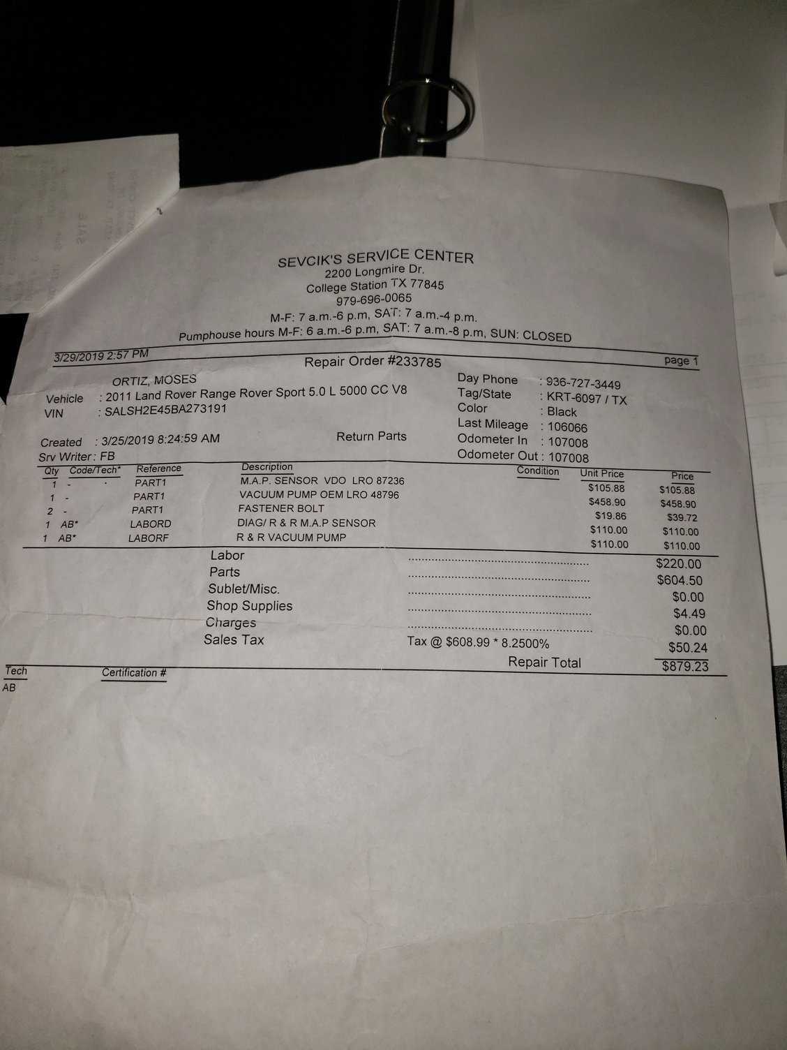

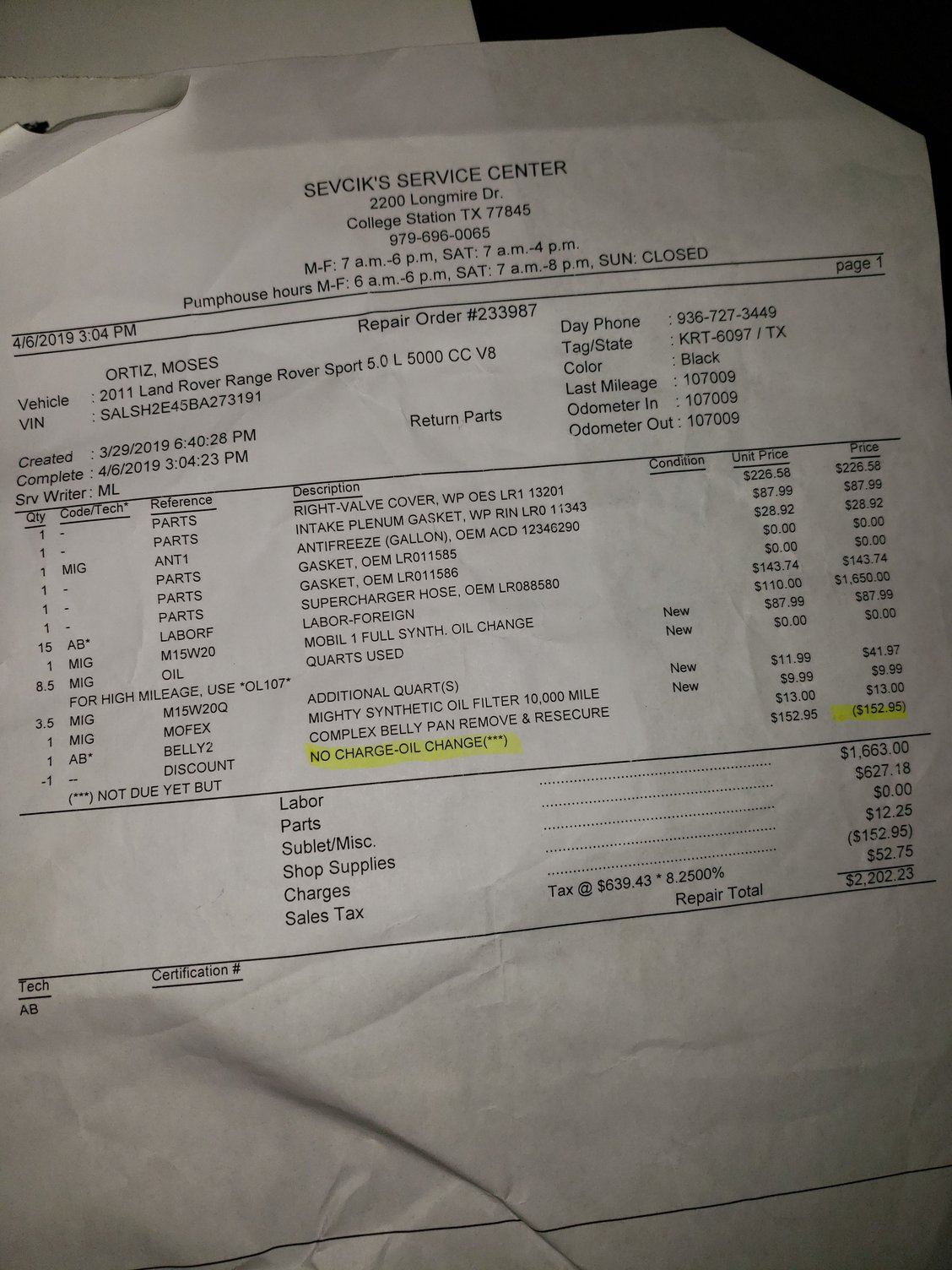

Still not 100 percent sure but what I got out of it was I took it in to get the whine fixed and it had started to shake and smoke before I took it. Turned out it was a vacuum issue and a maps sensor issue. That my first receipt. They did some work to it and when I picked it up it was still shaky I left it there and told them Its still not right. Then they found I had a valve cover seal leak. The second ticket fixed that
First
Second
