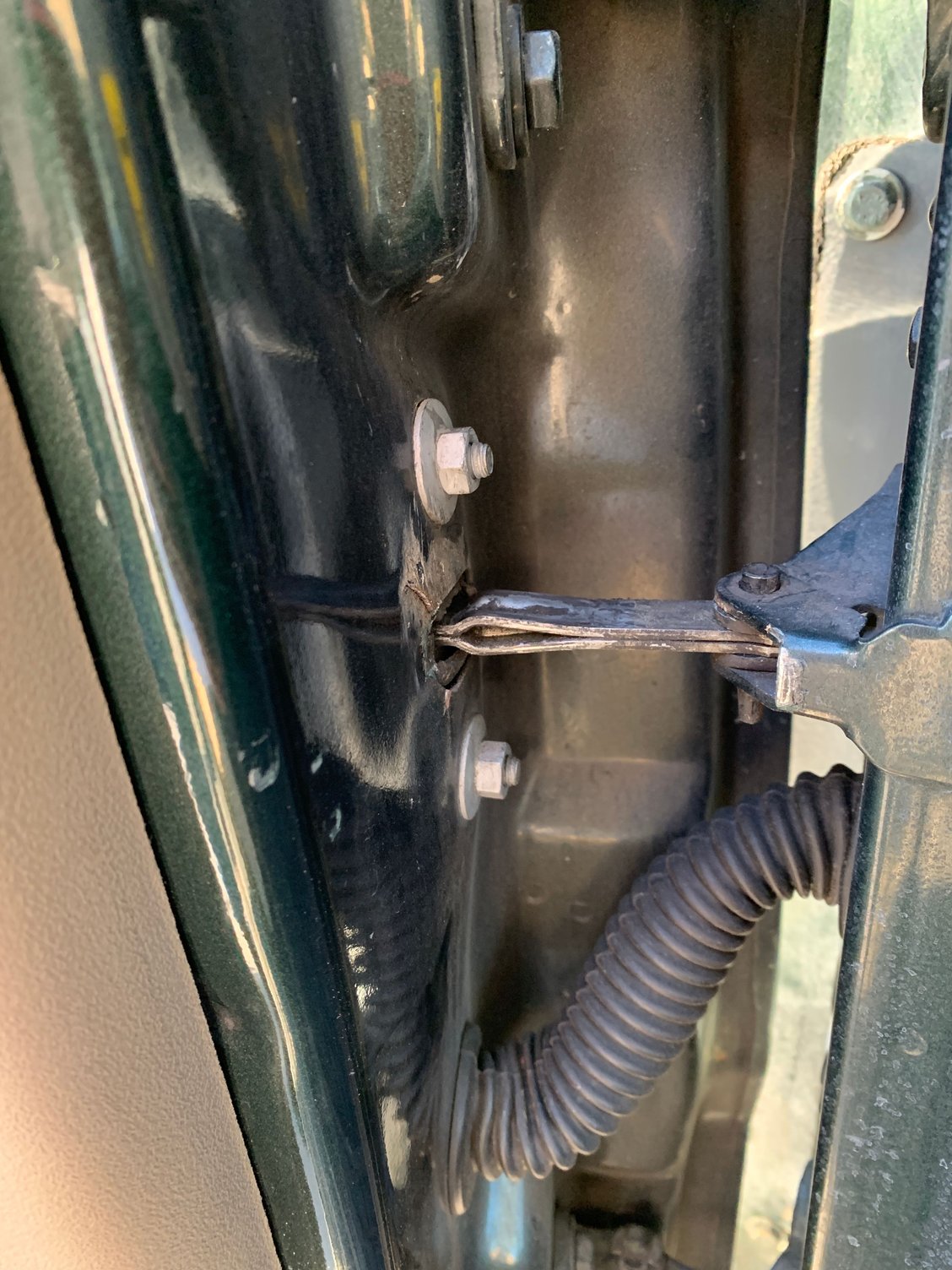

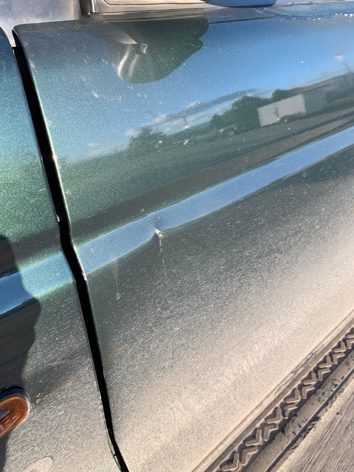

Stopped for gas, reached for the low door latch, and the instant it unlatched, the 59/60 mph winds yanked the driver’s door out of my hand and tried to turn it inside out. Damage is pictured below. With the door release where it is, and the wind, I had no chance of catching it. Lots of colorful language ensued. Lots.
I will need to to bend the door panel back st the door stop, The pulled out section is dimpled outward, and now interferes with the door stop bracket in the last 2-3 inches of closing. Otherwise, thankfully, the door closes normally and is straight. For about a minute, when that door whipped backwards, I had visions of the trip ending right there.

When we stopped for gas in Billing, 60mph winds yanked door right out of my hand.
Wind pulled door backwards, twisted metal at door stop (pulled it outwards Ľ”), and door hit front fender.

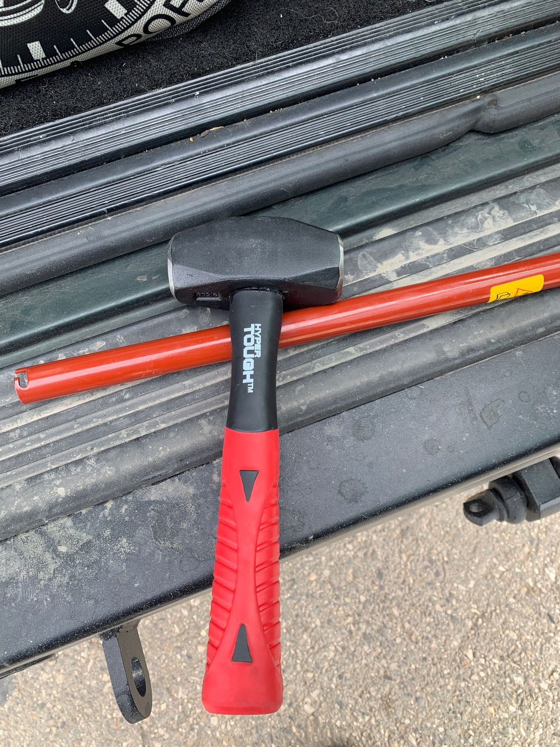

This morning I went next door to the Walmart and bought a BFH for $7.24. I used this with the pipe from the tool pack for the jack handle, and whomped on the washers on each of the door stopper studs. It pushed the panel back into shape, and everything shuts as it should now. Just need a couple of dabs of touch up paint after the trip.

Hammer, jack handle pipe, and a few choice blows put the driver’s door back into shape. I did remove the door stop pin, so I could open door farther, and get a straight shot on each washer. Worked the treat.

I should have mentioned that my Disco came with two complete tool kits, and a couple of additional loose spare tools. So I had a spare jack handle to whomp on when I fixed the door. If I only had one, I might have been more careful, or chosen a different tool/method.

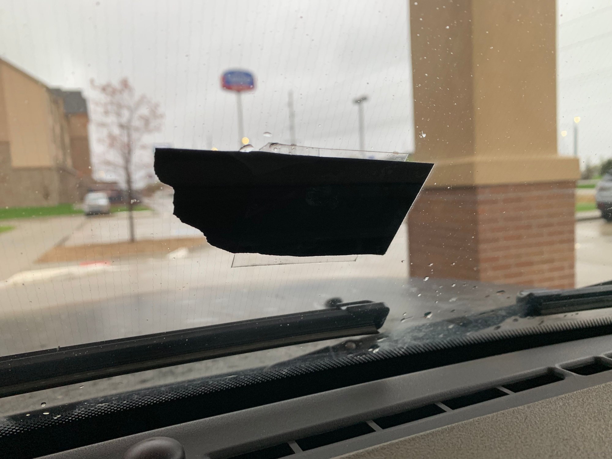

And shortly after this started happening, we got a busted windshield courtesy of a rock truck in eastern Nebraska. We managed to find an AutoZone right before we stopped for lunch to visit a friend in Sioux City. So during lunch I set up the bracket and glued the starburst. It’s about the size of a dime, so I don’t have hopes for hiding it completely. I just want to keep it from spider cracking across the windshield until we figure out what to do when we get home.
So we followed the instructions on a slightly cloudy day, and left the bracket and the resin to cure while we ate lunch. We came back out and did the second step where you fill in the final bit with resin, cover with clear plastic, and are supposed and point it towards the sun to cure. It was cloudy, so we solved this by turning the defrosters on high while we sat in our friend’s car and talked about old times. We taped the clear piece of plastic over it and left it on all day for the ride, just in case.
